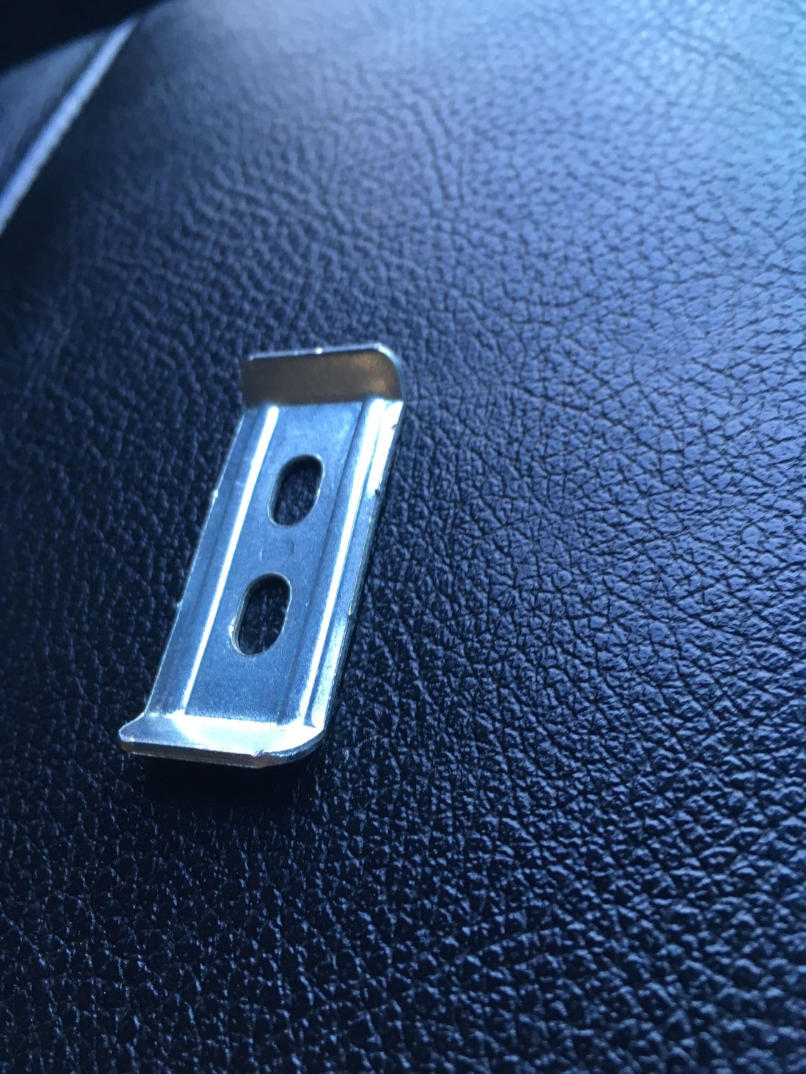

Notice the 2 tabs on the bottom clip that keeps the mirror from sliding off of the bracket.
I cut the piece of wood so that it was wide enough to fit tightly and not fall out.
Toilet paper wall mounting bracket.
At this point I just pushed the metal bracket towards the piece of wood lightly and held it with one hand while I started sliding he mirror off.
I bought my truck recently from a used car lot and noticed instantly that my mirror was vibrating constantly and it was really annoying! I took my truck to the dealership, called a tint shop and even went to a popular automotive glass company and spoke with a "technician" there. Nobody wanted to touch my mirror and if they did they would not be responsible for paying for or replacing my glass if it broke during removal of the mirror. I went back home and decided to just do it myself.
I have attached pictures of what I used and what worked for me. I suggest working very slowly and being careful. I decided that the tools I have seen to do this have a small pressure point contact area on the glass and that is probably the primary cause for the glass to break because the force is so focused. I decided to use a thin piece of wood to disperse the surface area and pressure caused by prying. I used an extra metal wall bracket for installing a cheap toilet paper dispenser because it was already bent and very strong.
I put the wood block up in the bottom opening of the mirror bracket against the windshield and slid the metal bracket between the bracket and the wood block and slowly pried until I felt some like the clip should be released and pushed the mirror arm up off of the mount.
Once I got the mirror off I found that the metal clip that is anchored to the mirror has 2 rivets holding it and they were both VERY loose. I used a drift pin and flattened the rivets down some more with a hammer to tighten them. I held my mirror against a block of wood padded with a towel so it didn't mess up the finish while I was hammering.
Reinstallation on was as easy as sliding the mirror down onto the bracket.
