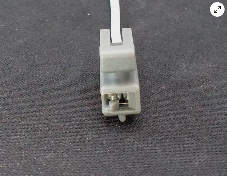

I was wondering if a loose connection at the stator plug...
...might cause the issue and causing the light to come on? It seems to have trouble seating at the alternator.
