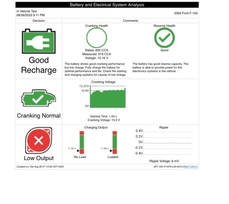

last night advance auto didn’t want warranty their battery that’s less than 30 days unless I had the paper receipt bc I got it from another one of their stores. New battery last night tested good but alternator tested low output last night while installed.

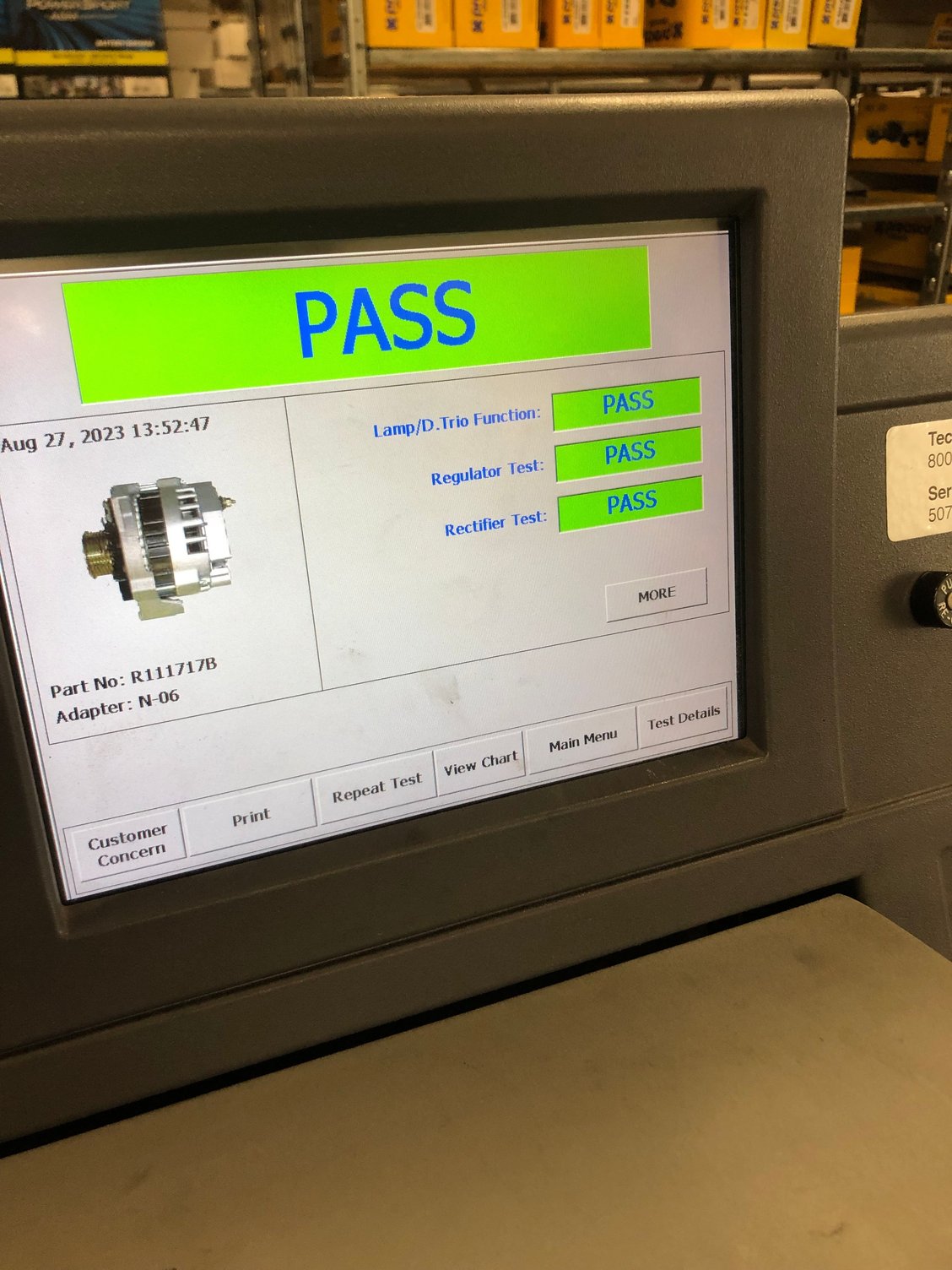

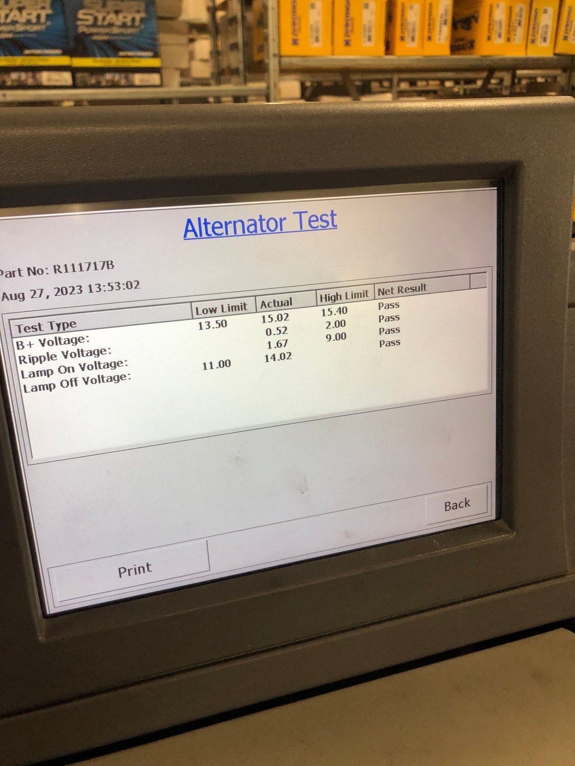

took alternator today to Oreillys off the truck and it test good.

can alternator work intermittently?
one test is good and one states low output

You have to further test the system on the truck running to verify what you have.
Used Alternator may have worn Brushes or worn Commutator.
This can be a problem relying solely on off vehicle testing. Same with Starter issues.
On running vehicle, the Battery voltage, right after starting will be getting its recovery charge. the voltage will be raised toward 15 volts to accomplish this.
Since the Battery is new, it should recover quickly within less than 10 minutes unless the Alternator and /or the Battery is faulty.
When recovery has taken place the Battery voltage will go down to close to 14 volts and remain there.
You have to fill in with these observations and not rely on off vehicle tests to be sure, and check/clean cable terminals and ground to be good.
You have this responsibility and not put blame all on others when plug and play does not work unless you verify a proven faulty part..
Too many people, sources and time involved and opportunity too make excuse on unproven basis.
Charging system is very simple two parts and cables/connections and likely a field fuse to power the field winding in the Alternator that if blown there will be no output..
