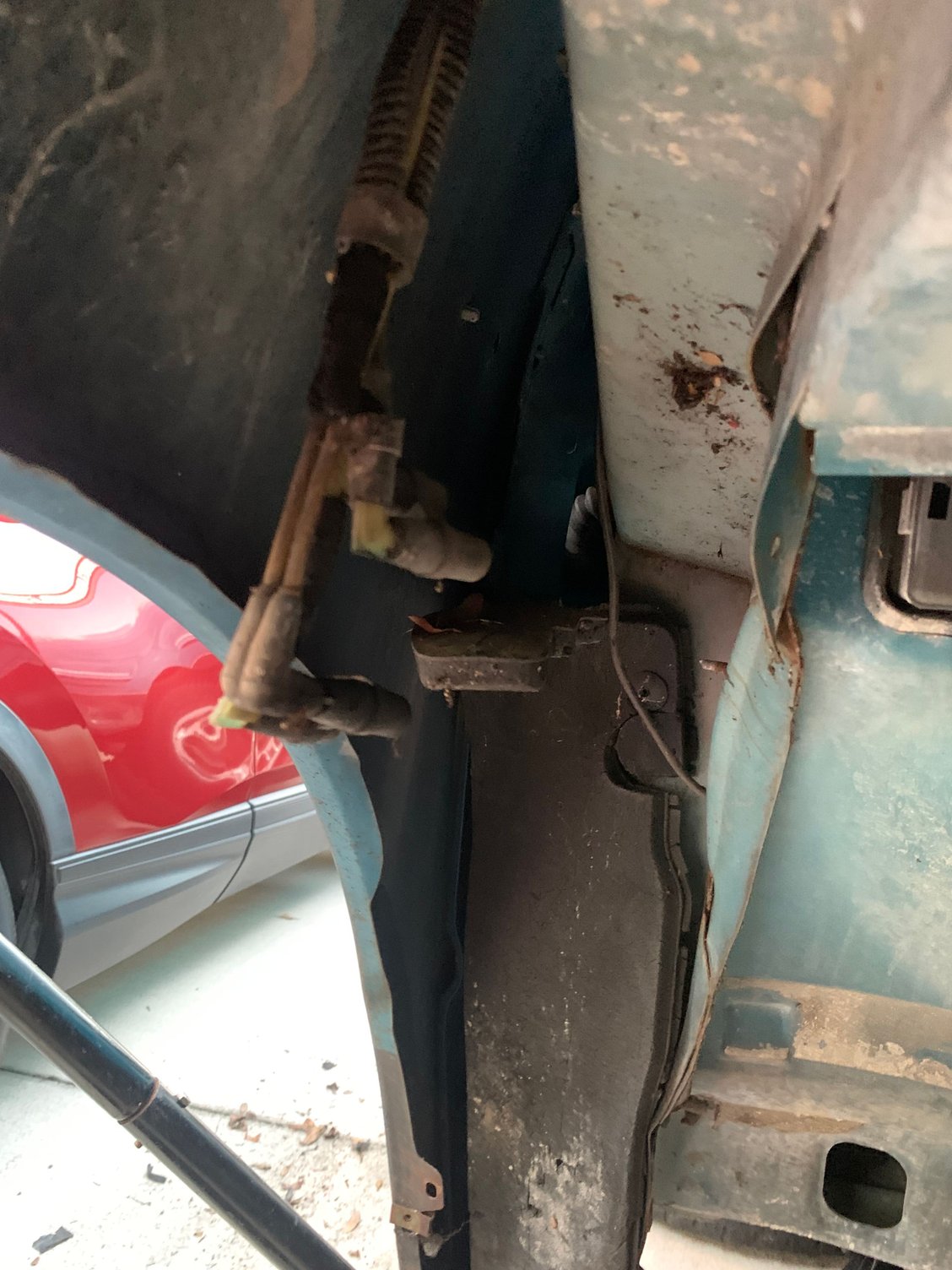

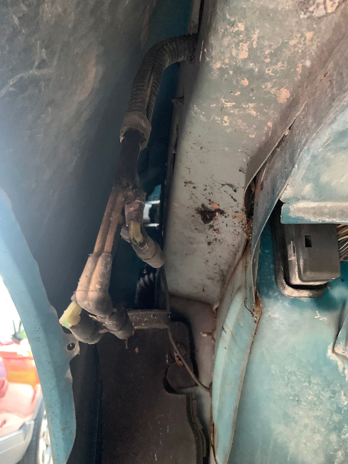

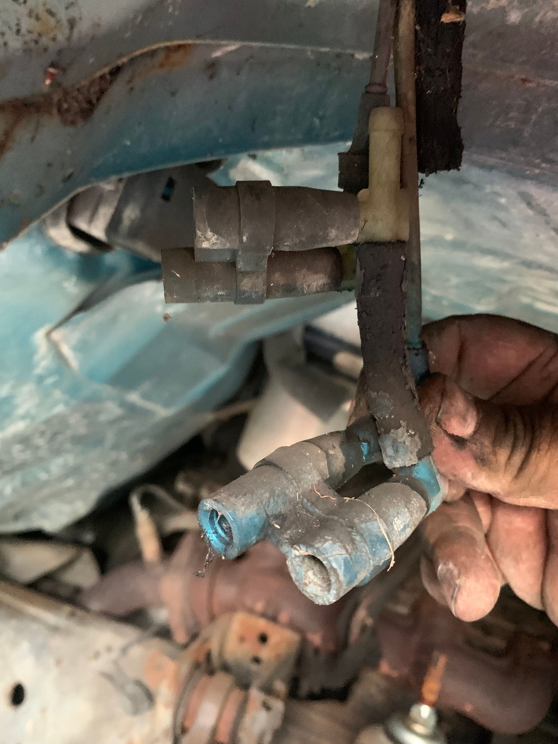

Update * gas leak
I pulled the inner fender liner on the passenger side to find the Gas leak is coming thru what looks like a vacuum line that's supposed to be connected to the HVAC box??
Passenger side inner fender

check the lines going to the fuel pressure regulator - it may have ruptured the diaphragm
Old Oct 24, 2022 | 09:22 PM
Slick92GS-R's Avatar
Joined: Aug 2006
Posts: 4
From: Homestead, Fl.
I traced those vacuum lines and one goes back a port on the intake manifold and the other goes back to the Fuel Pressure regulator. I installed that FPR only a few months ago. Didn't figure for that to fail so soon. I'm happy I kept the old one. Will swap the old one back on. Hope that's it. Thank you!!
