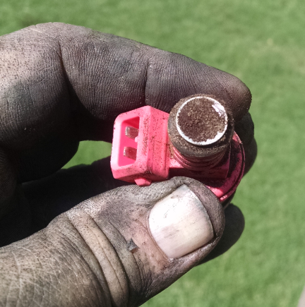

Low fuel pressure may be something as simple as clogged fuel filter. My son's 2000 F-150 had low fuel pressure and it turned out to be just that. He also had a rusty fuel tank inside, which contributed to the problem because the injectors were plugged with granular rust. See photo....I endde up replacing the fuel tank (complete with pump and sender) Rock Auto ~~$300, all injectors ~~$100 and cleaned out the fuel rails and lines with carb cleaner and compressed air. Never ran better!
