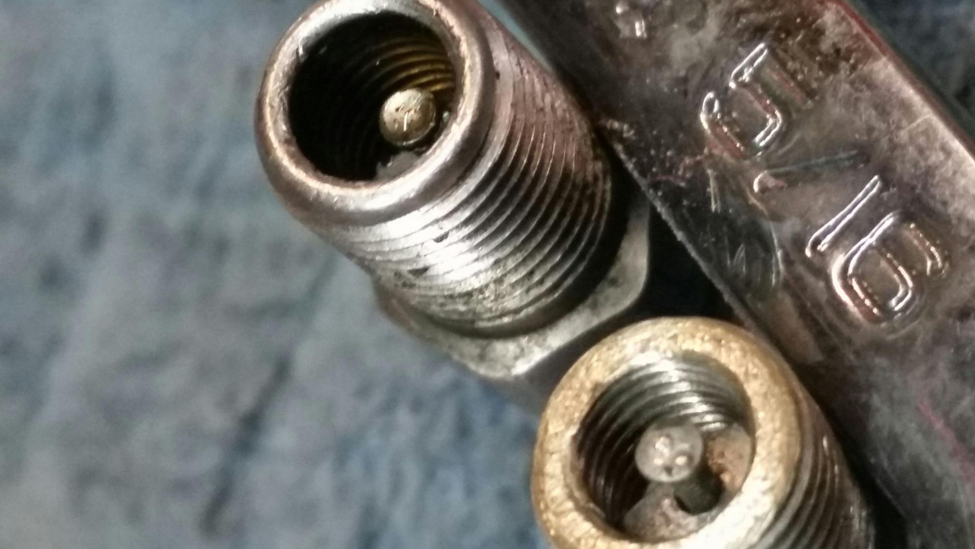

2002 SCAB 5.4. Is the fuel pressure schrader port "special" on this thing? I have a hot no start That i am diagnosing i believe i have NO FUEL.... but i also do NOT have the correct adapter either...SEEMS like? is there something special about this schrader? other than it is very deep?

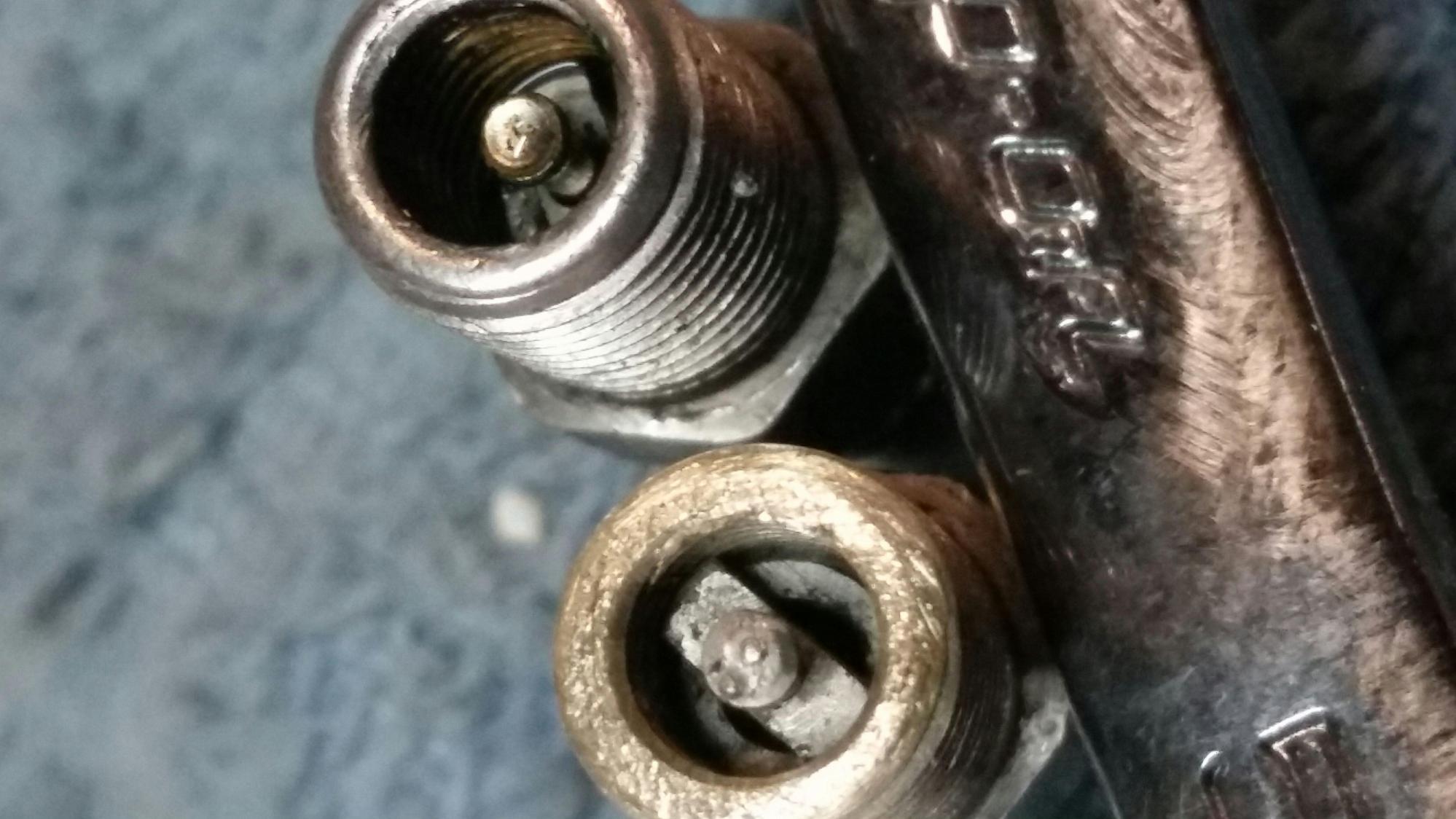

adapter screws onto schrader.....but the "valve: on the fuel line is quite recessed not allowing the valve in the adapter to contact it.

but the schrader valve is/was an issue...seems the valve assembly is .120 below the top surface. I measured some others i had laying around ....they measure .050 below top surface. Measured adapter..it allows the "plunger" to go .060 after top surface contacts seal.....so there is NO WAY the "plunger" COULD contact the fuel rail schrader "valve"........so (since i had another after intake swap) I simply removed the valve assembly ...remove valve....ground -.070 off top surface, refinished edges and installed on vehicle. Works as it is supposed to.

has anyone ever found a different fix for the recessed schrader valve? My 01 king ranch 5.4 is exactly the same way. Can't test fuel pressure due to valve not high enough for the ford adapter to open the valve.
I did unscrew the valve some and it stated to work but it also leaked all over the place.
