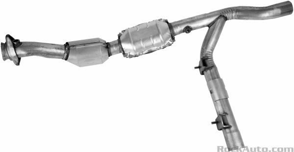

Did you swap all 4 cats?

I didn’t know there were 4 cats, we just swapped the two
Old Sep 10, 2020 | 12:46 PM
Posts: 43,542
Likes: 819
Left
Right
