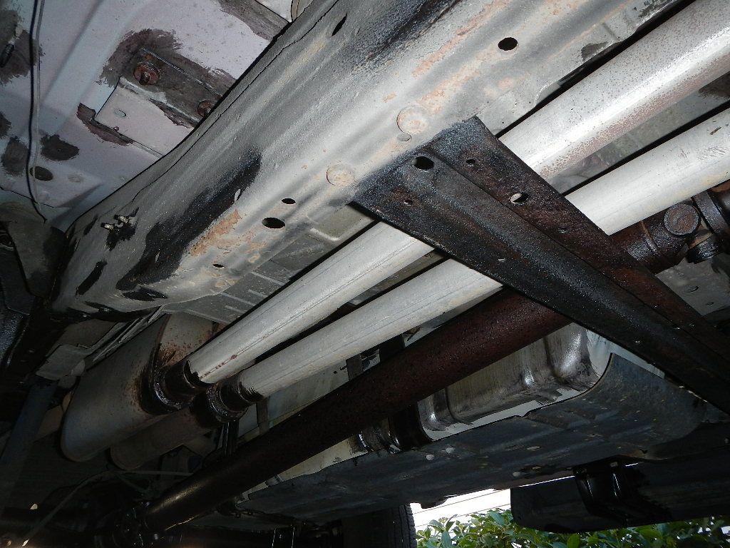

It looks to have: True Dual Exhaust.
at bottom of picture the exhaust pipes are running towards the Front of the vehicle, the left pipe is turning left crossing over to the left exhaust manifold.
Side view of the 1st pic, from the passenger side of the truck.. Front of the vehicle is facing to the Right, in the picture.
Mid exhaust pipe area, running to the rear of the truck.

That tells me you probably have valve guide leaks on bank 2 somewhere. Note that #5 is on that bank. If you had a H-pipe or X-pipe, both sides would smoke. Note that it would run better with a X-pipe, you are losing low end torque without it. You can buy a dual in/dual out muffler with an internal X-pipe.

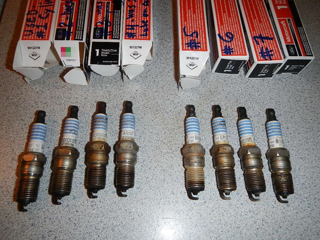

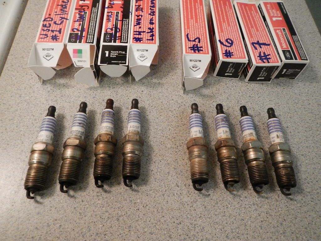

[QUOTE=glc;5263928]
Can you post a pic of the #5 plug alongside one of the others so we can see the difference?
I am attaching pics of all 8 used spark plugs that came out of the engine.
#1 - #8 / Left to Right
(when I pulled #7 & #8 spark plugs out yesterday, they were both Equally tightened into the head. Each took very minimal force to start them loose, a little more force than the loose #2, #3 & #6... those 3 were were probably Finger Snug at best. #1. #4 & #5 were tight in the head.)

The tips all look normal, if anything, burning a bit rich. The top threads on #5 look like there may be water or coolant getting into the well from up top. The bottom 3 threads are all that screws into the head, this is why they loosen and blow out when not properly torqued. The original design plugs only had 4 threads, the barrel above those threads was smooth.
The heads were redesigned in 2003, the new heads are fully threaded. The new plugs for those heads also work in the old heads, and have replaced the original spec. They looked something like this:
