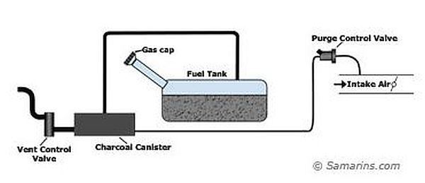

https://www.samarins.com/diagnose/p0455.html
You have a large leak somewhere in the evap system, the gas cap is only one of several componentrs.

I wouldn't drop the tank just yet. Lots of lines to check since the tank is vented to the intake manifold typically through a charcoal cansister.

The purge control valve is under the hood right near the power brake booster.

The PCM opens the Purge control valve as part of the fuel tank system test.
Code 455 is telling you there is a ' large ' leak detected, as part of the program Logic decision test for draw down limit failure.
Like hose cracked, rotted, filter fault, hole in tank, Vent valve stuck open, tank fill neck issue, rust hole in tank, even the pressure sensor. that does the sensing etc.. Could even be under a mounting strap as a rust hole.
You can't find what you can't see.
Testing is in order to find the location.
The Evap system is a lengthy and complex combinatiion of tests at differeing vacuum levels, limits and parts functions.
A large leak says it can't get to " first base " in the test sequence
You might even have sucess using a hand vacuum pump at different points sectional testing but that's of hand squeezing and watching the Gage on the pump.
Just a side note, I have done this on old A/C sytems to evacuate looking for leaks, then filling with Freon, to sucess.with the vacuum level pulled down to 30 inches in the system... Again, it's a lot of hand work but should work if your inclined to do so and adapt to the system connection point of test and be sure your test connections are tight..
