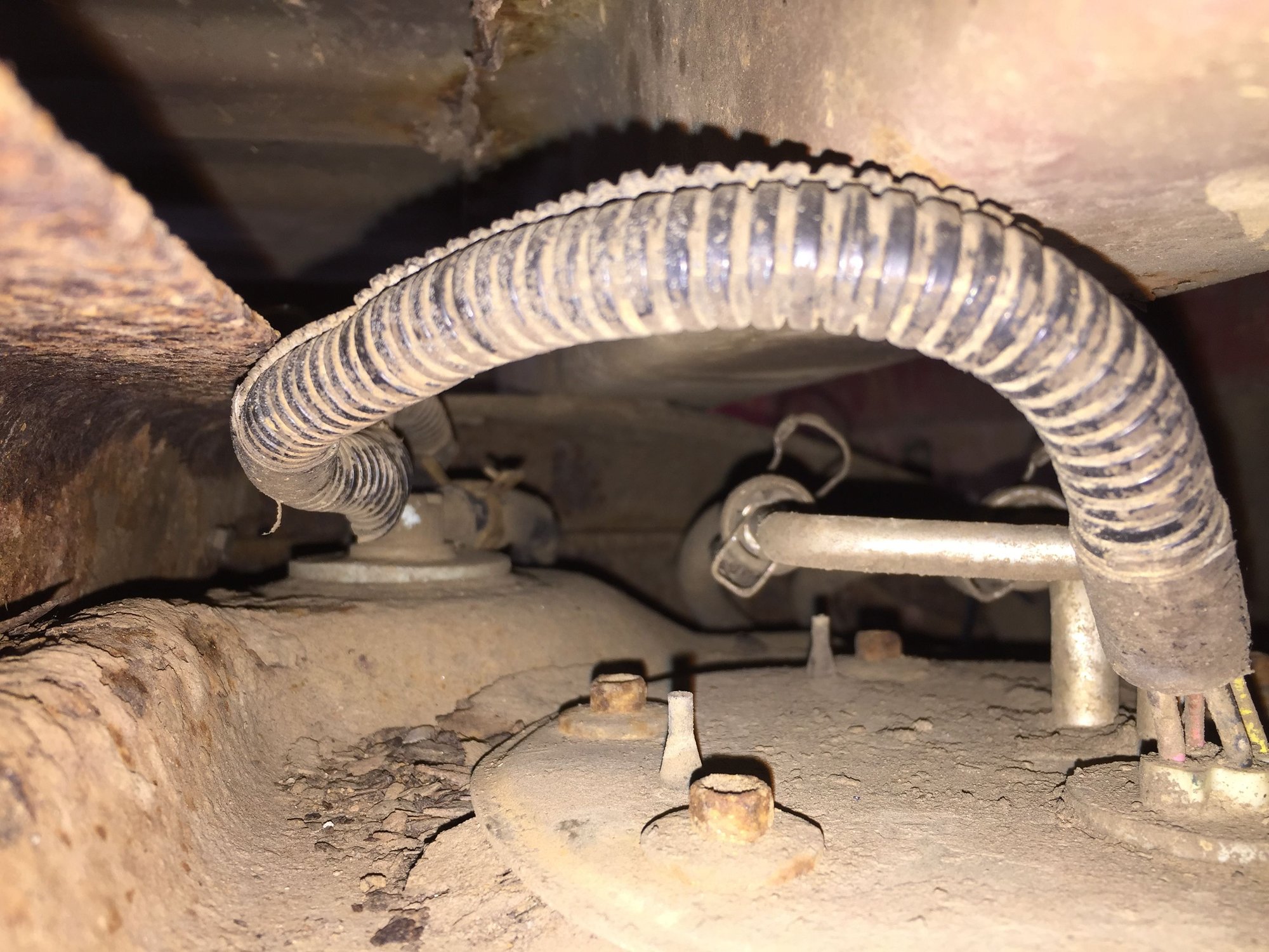

Here’s behind engine passenger side. And the tank air vent and pump. Not sure these will help I’m any advice.

Do you know what these are?
One with 3 hoses is behind the intake manifold passenger side. The other is on top of the gas tank beside the fuel pump. I looked up a diagram and it says tank vent valve at end of tank and a vapor vent valve! But I asked Ford dealership when I got the tank vent valve and he said his diagram didn’t have another valve. Just a pressure sensor. So I have a feeling it’s one of the two causing the problems!
