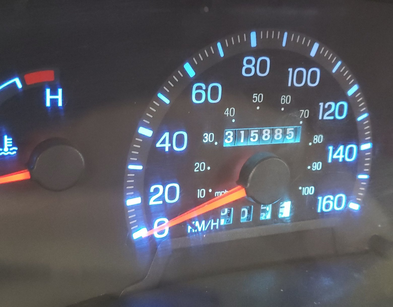

When I bought the truck it only had the right side of the instrument cluster working with lights. First night that I drove it of course the other 2 bulbs died so I pulled the cluster out and replaced everything with LEDs. I'm not pulling all that back out again until I put a stereo in this thing

I went with Blue LEDs
