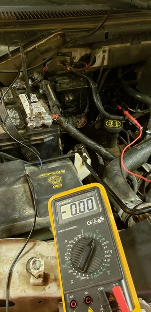

Okay so I think I'm testing incorrectly then. I watched a youtube video showing how to test these and so I think it may have been incorrect or based on a different model vehicle. So what I did was I took a test light originally and grounded it and then tested the two wires going to the coil plug. I got a flashing light for one side and then nothing for the other. According to the video I watched, I was supposed to get a steady light for the 12v side. So then I took a multimeter and I grounded the black wire and tested the 12V wire thinking I would get 12 volts but I got 0. But then I tested the other cables and also got 0 volts...obviously I did something wrong. Now I've already replaced the coil plugs so I don't think I would have a faulty one right out of the box. So now, from what you are saying (I want to be very clear), is that I need to ground the multimeter and test the 12V wire using the ohm feature instead and see if I get 10,000 ohms? Is that right?

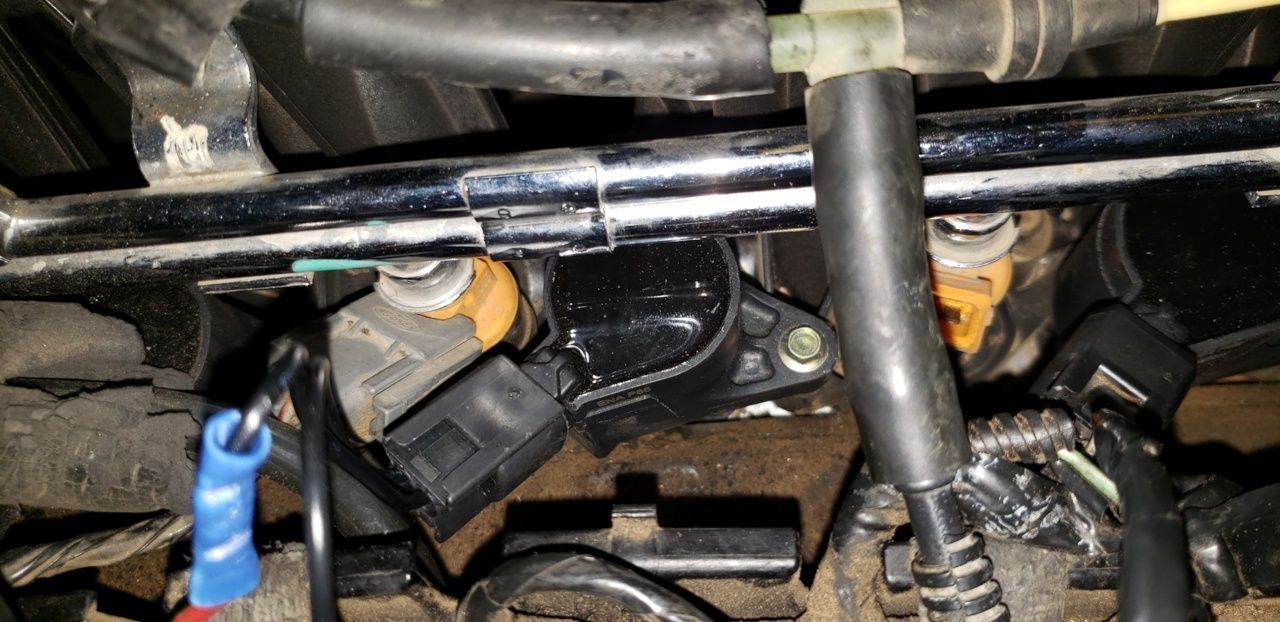

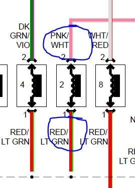

Okay so I found a schematic and I took some pictures because I don't know what I'm doing exactly.
full schematic here
Below is a Partial schematic shown where I took measurements. From Pink/White to ground (battery negative terminal) I got 0 volts. From Red/Light green to ground I got -.20 volts. I took these measurements from the Run position. Pictures below. I also measured from the Red/light green to the Pink/white in the run position and got 0 volts.
I hope that was what I was supposed to do.
Not sure how to do this. "Plug up the coil, start engine. Measure for voltage on ground >(the lead going back to the PCM) > side of coil with voltmeter function" How do I measure when the coil is plugged in? I took a picture of the coil if that helps.
This as far as I got because I wanted to try and make sure I was doing it right. Thanks again for the help.

Oh I almost forgot, I did use the ohm feature to test from the Red/LT Green cable side of the connector (pretty sure that's the PCM side) with motor off and grounded to battery terminal. Here is what I got.

In your post #11 where you tried to measure across Red/Gn to Pink/Wht with ignition to Run and got zero volts is of course NORMAL.
It proves nothing doing that but shows you have little understanding that there will be no voltage drop to see >>>>unless current is flowing<<<<<..
Current will not be flowing under those 'static' conditions.
Your getting mired in detail you don't understand.
I see your using a Fluke meter which is a good make. but you need to pay close attention to the screen for info on what it being displayed.
We can not see that in photos, only a reading.
If you would follow my post, it will cover everything end to end for voltage and resistance readings and leaves out all the detail that would add confusion.
From it you have to deduce the fault.
With the ignition switch in RUN, BOTH sides of each of the eight coils should read battery voltage (coil connected). A reading of zero volts indicates that there is an open circuit on the supply side (RD/LG wire) back to its source.
Go back to post #5.

The way he has it shown in post 11 circled won't read any voltage across the coil with ignition switch in RUN unless the motor is running and PCM is pulsing a ground to the pink lead.. That is a normal expectation my reply is based on.
