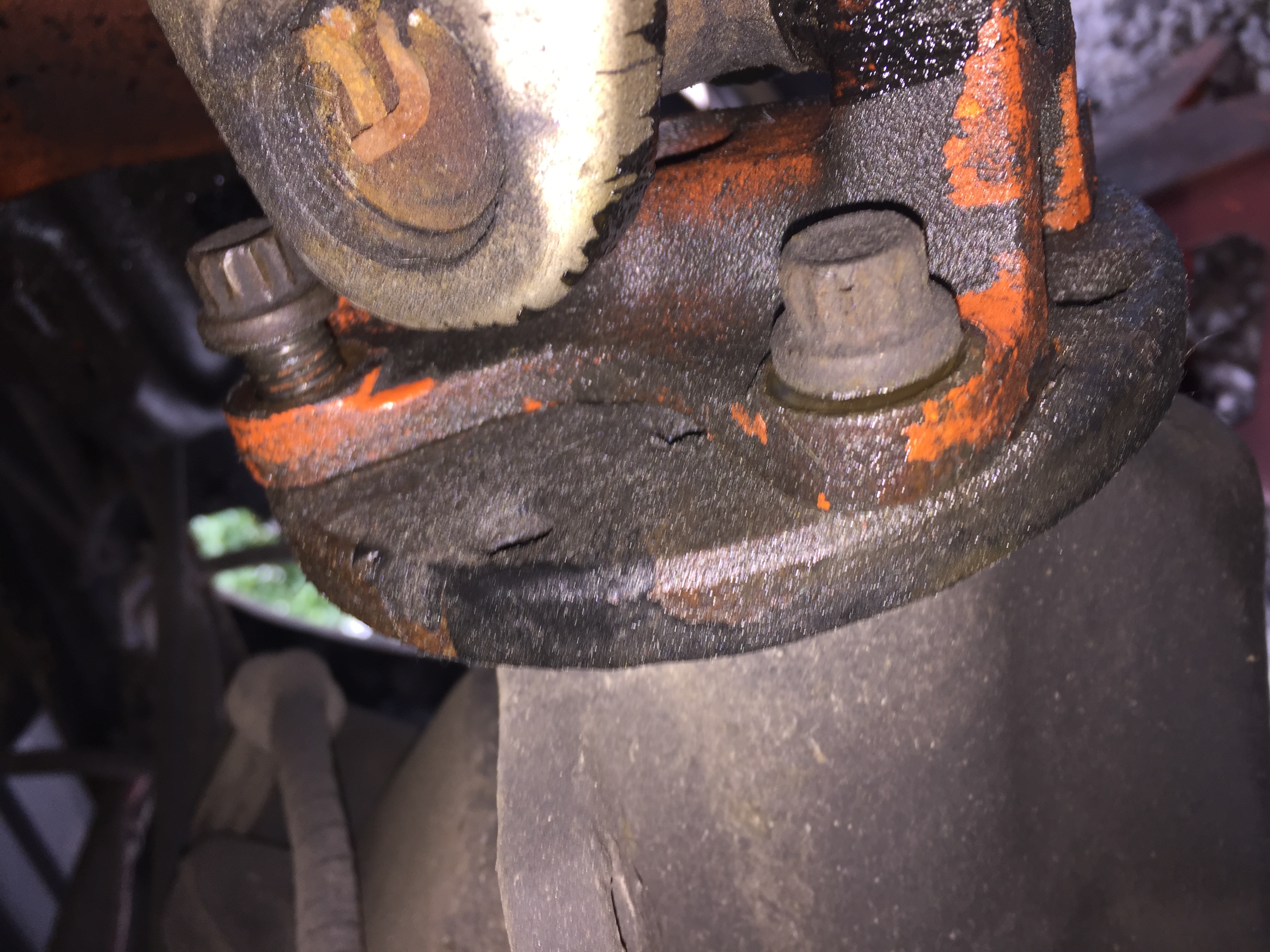

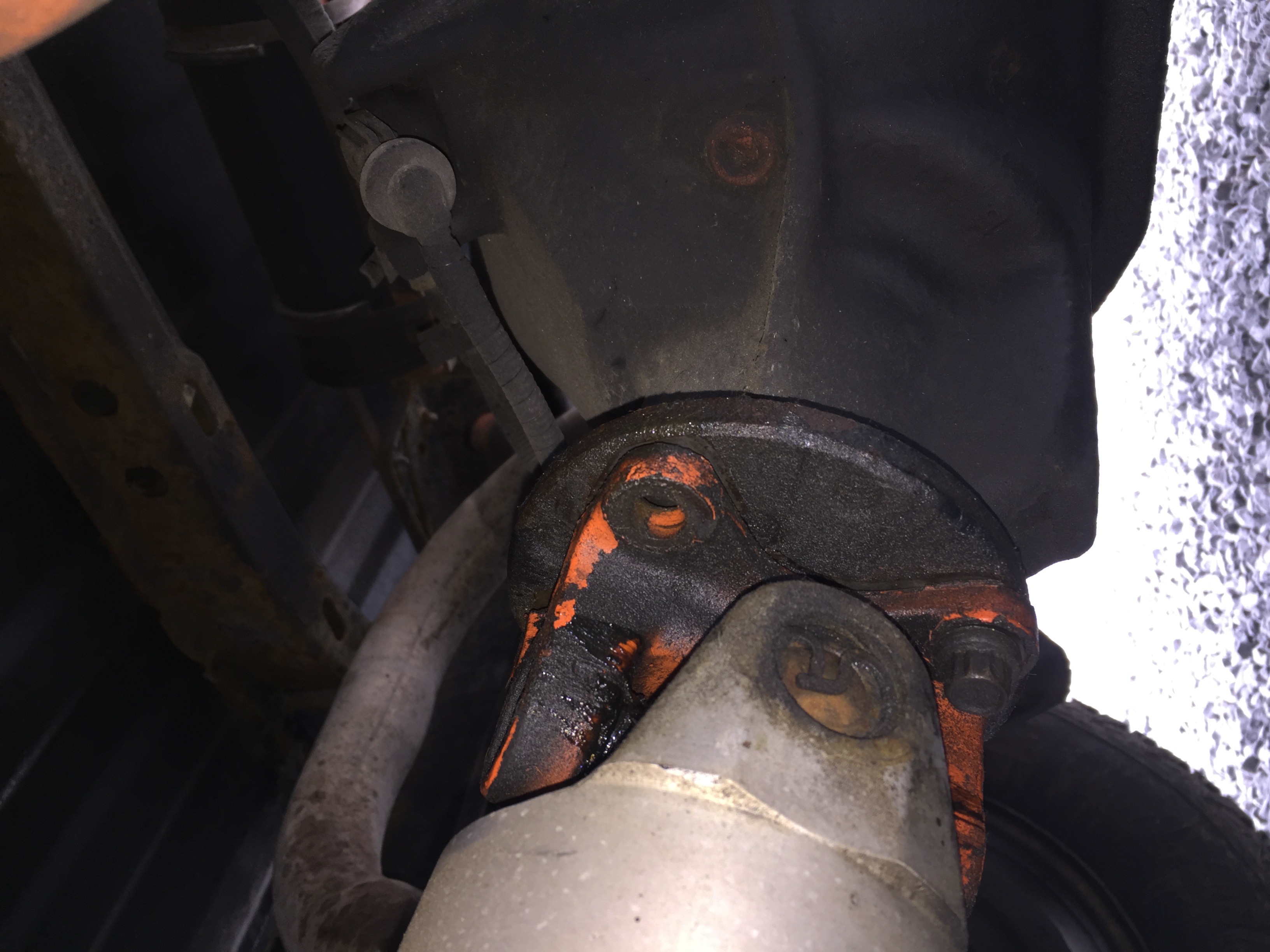

Smile Resolved
Issue resolved, the rear yoke was missing one bolt and a second one was halfway out; the remaining 2 I could remove with my fingers. The vibration was caused by the yoke slamming against the halfway out bolt. Got 4 new bolts and installed them ensuring they were torqued to 60 ft lbs.
Thinking back to last fall, I recall my friend reinstalled the driveshaft after we did some work under the box; I think he used the German method of torquing - gutntite - grrr
