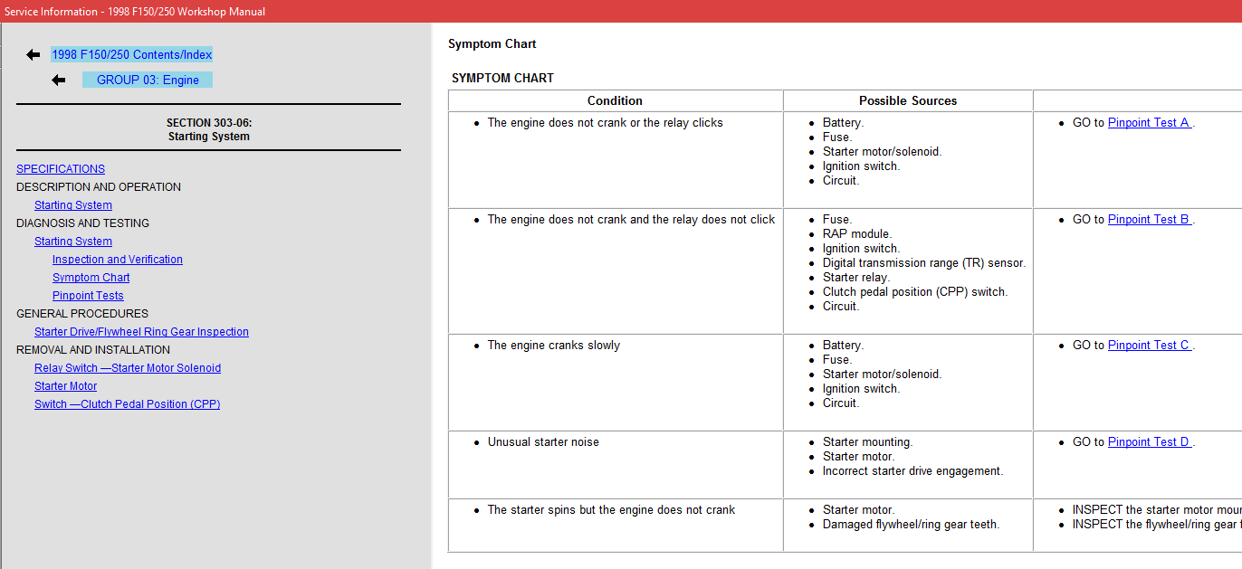

Yeah ... in park and I can turn the crankshaft.
I found this rather robust diagnostic guide in the service manual I'm gonna go through in the morning. I figure if this doesn't track it down, nothing will:

well ... that was easy. Continuity check between positive terminal on the battery and the starter solenoid shows no connection. So, time to replace my 19 year old battery cables.
