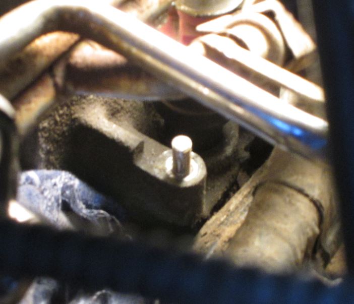

The Bad - broke top of coil bolt off, so coil just sitting on motor. Possibly enough bolt sticking out of head base to grab and hopefully remove, again tight area, but how much vibration risk is there in the short term (still pretty cold out here).
Broken Coil Bolt is in a bit tighter than I expected. Pliers and vice grips slipping, and don't want to break it in place. Any ideas for bolt extraction in this tight area?
Thanks, but haven't found an extractor small enough for the 5mm bolt. Only found 8 mm and 1/4" and up. Tried cutting into top and using a Phillips screw driver but edges broke on the try, and picked up a bolt remover plier but it still strips. Didn't want to break it but may have to drill. It's only sitting there for now.
