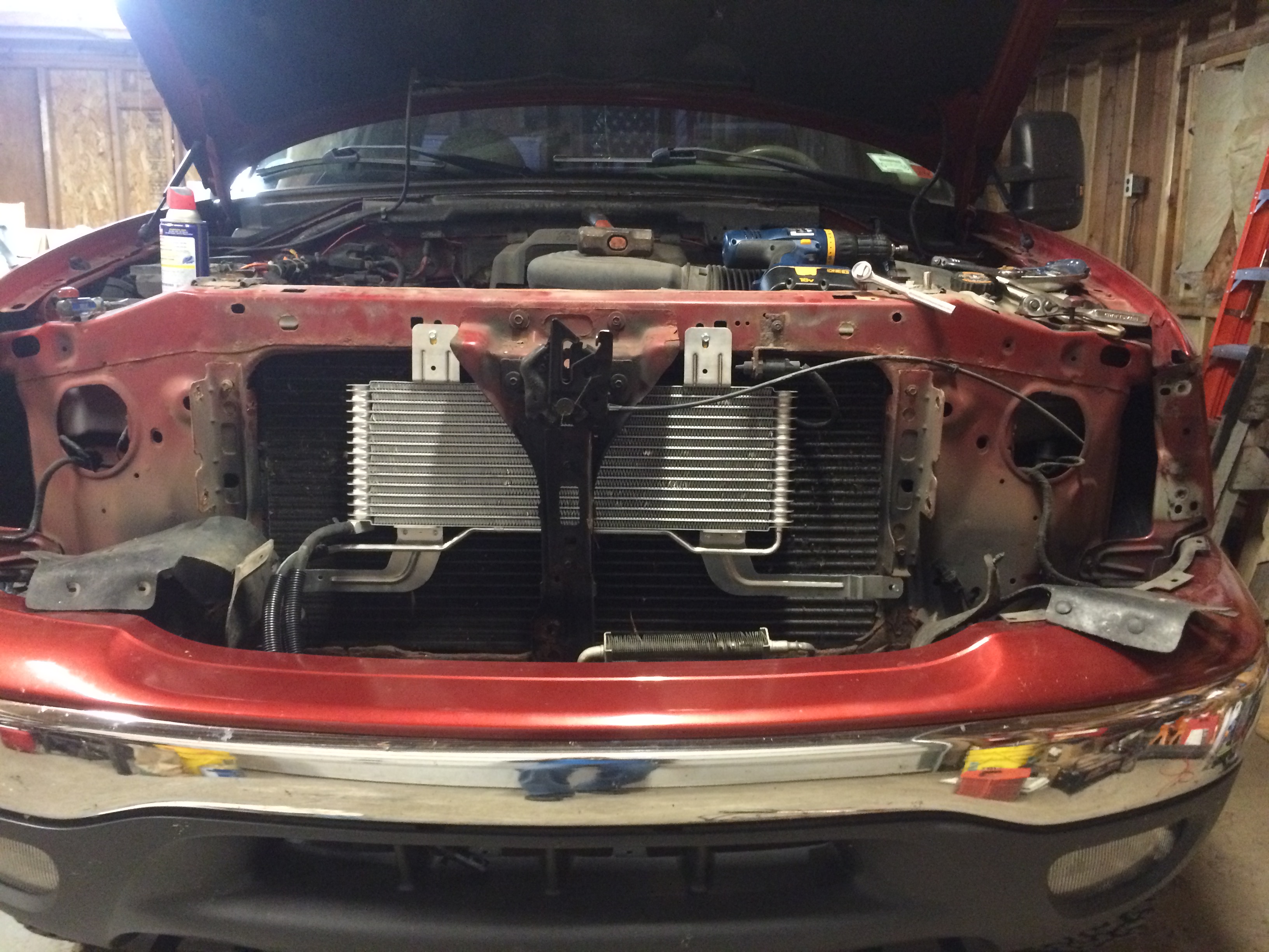

Install a cooler from a SuperDuty. Fit like a glove and dropped my transmission temps 40-50F while towing. Gotta take apart the whole front end to shoe horn it in, but it really wasn't a bad job. I used a cooler from a 2004 F-250 with a V-10. The diesel version has fewer plates.

Went it comes to replacing the cooler itself, I'll try to get what oldnnew suggests and get the v10 cooler
