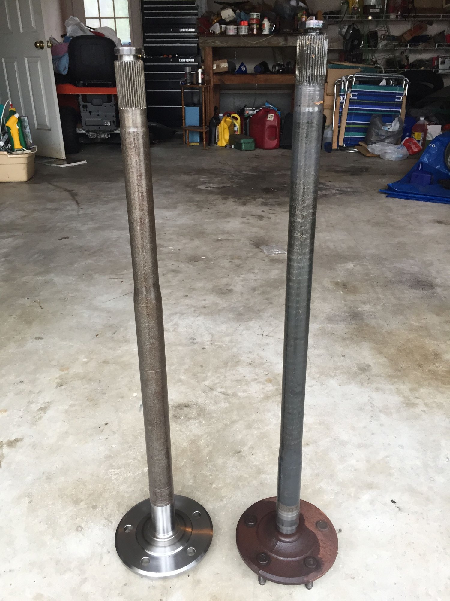

Dorman makes them and they are available from rockauto. There is a tag on the rear that will help identify the axle. The larger one on the left is yours I think. I ordered the wrong one and had to send it back and get the smaller one like the one on the right. Except that yours will have 7 lugs.
Correction! Dorman doesn't have 7 lug axles. I just looked!

For the regular F150 axles, you can buy an axle bearing that is offset so that it rides on a clean surface of the axle not where the old bearing surface is that is worn out. Might be worth checking in to.
