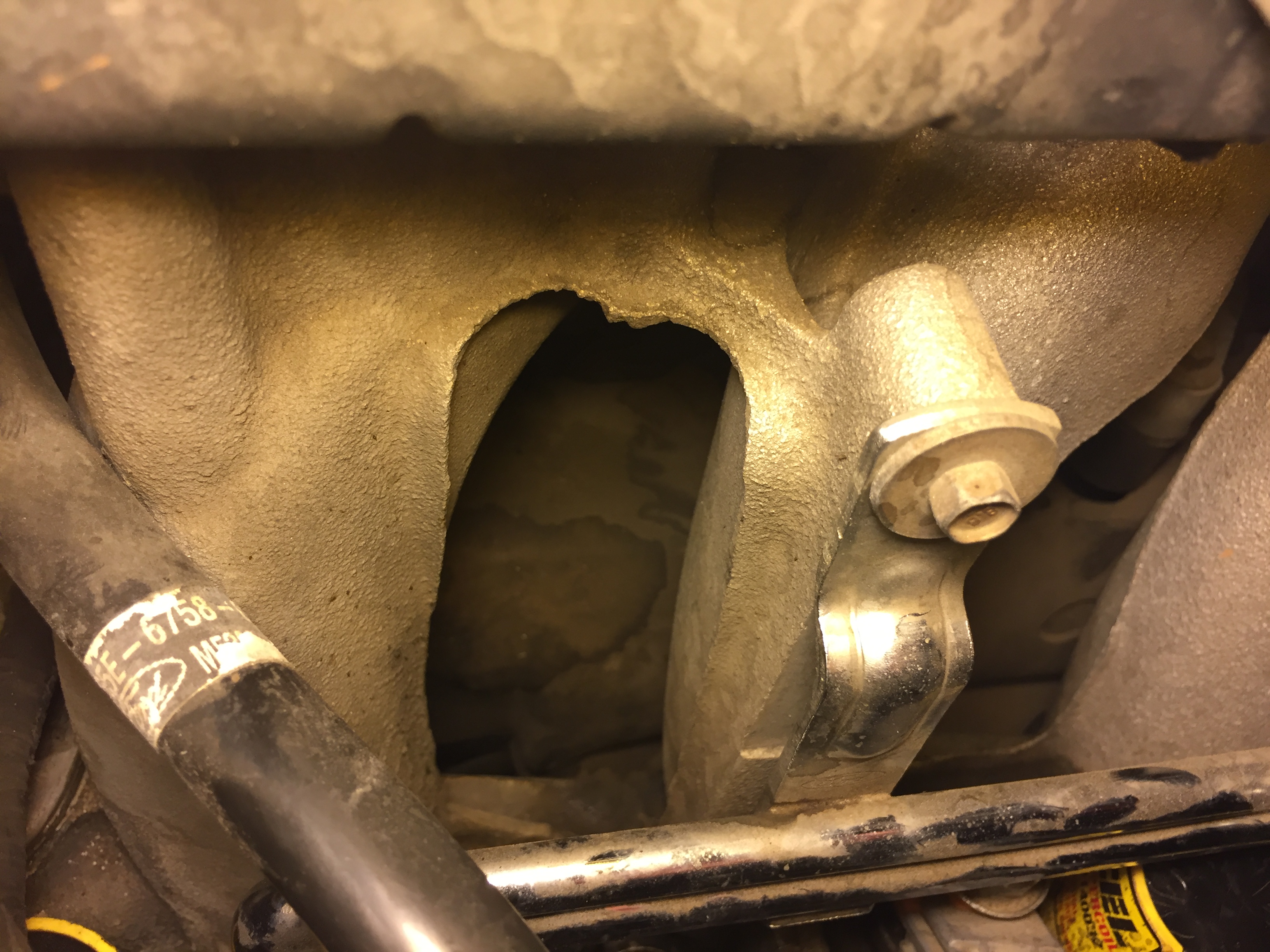

I removed the coils around #6 and found no moisture and no new moisture in on coil 6. Took a few pics of the area around because it looked like moisture marks were present. The pictures are behind the #6 coil inside the manifold. I know they're crappy but its the best I could get. Any ideas?

Have you pressure tested the cooling system yet? Since you had "coolant" puddling in the #6 plug hole, I'd leave that coil out when you pump the system up. Then just watch what happens when you pressurize the system.
