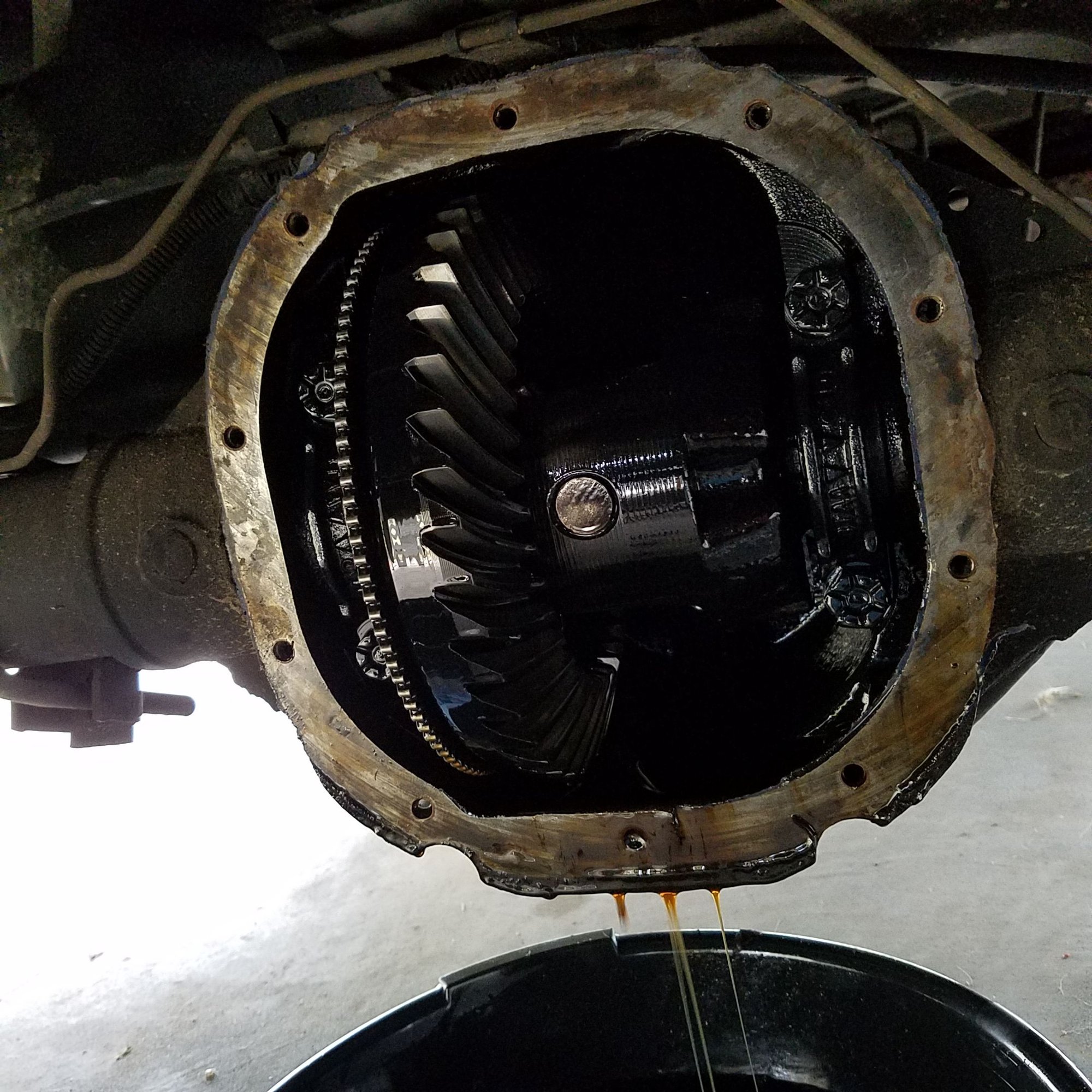

Thank you very much for the info. It was very helpful. The oil that drained out didn't look bad at all, but the fill plug had a gray sludge or grease type blob on it.
In watching a you tube video someone was saying gray sludge in the pumpkin means it's a sign the axle is going to grenade.
Any truth or insight to this?
Oil dripping out looks pretty clean
Sludge on inside of filler plug

Filler plug may be magnetic to attract any metal particles from normal wear. Not an issue.
