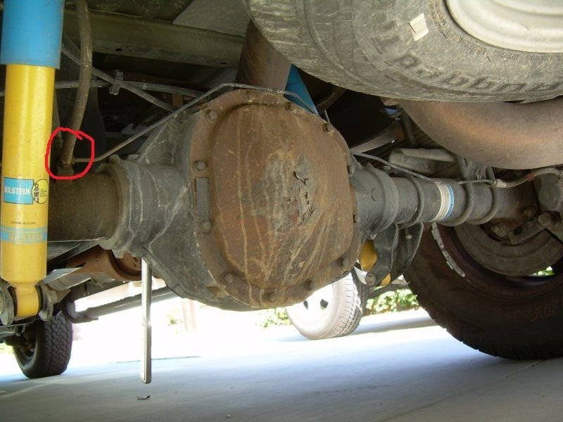

Something else I forgot to mention that I found yesterday while i was under the truck; there's a rubber line that connects to the brake line splitter(?) just to the left of the rear diff on the axle housing. Its broken right off the nipple on the connector. It feeds up onto a connector in the frame and I cant see beyond that, but it IS broken off the connector, and the connector that sits in the frame is very loose.
This is a google image, but this is the exact line that's broken in the circle. Is that a vent of some sort?

The rubber hose is the vent for your diff.

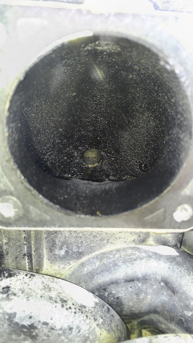

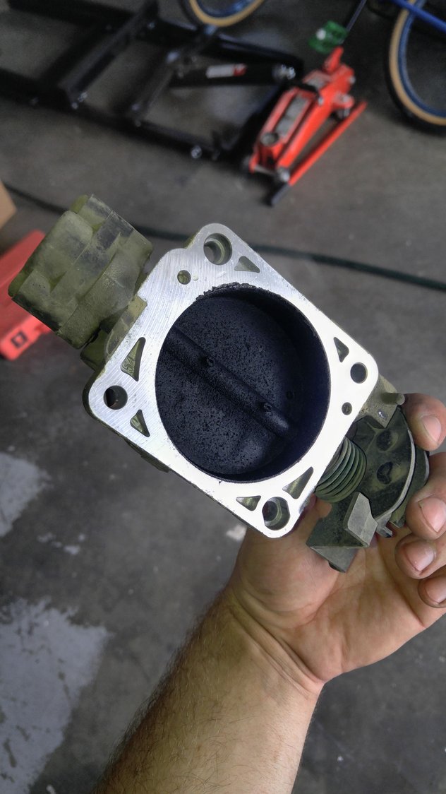

Well i didnt find any obvious vacuum leaks. But then again the probpem is intermittent so if its a vacuum leak its not a constant one.
Pulled off the throttle body and dear god.
I cleaned it up about 95%. I forgot to take an after picture but there was some stuff i couldnt get off with my crappy old tooth brush.
Here's down the elbow. Equally as coated as the TB. So where exactly are these egr ports?
