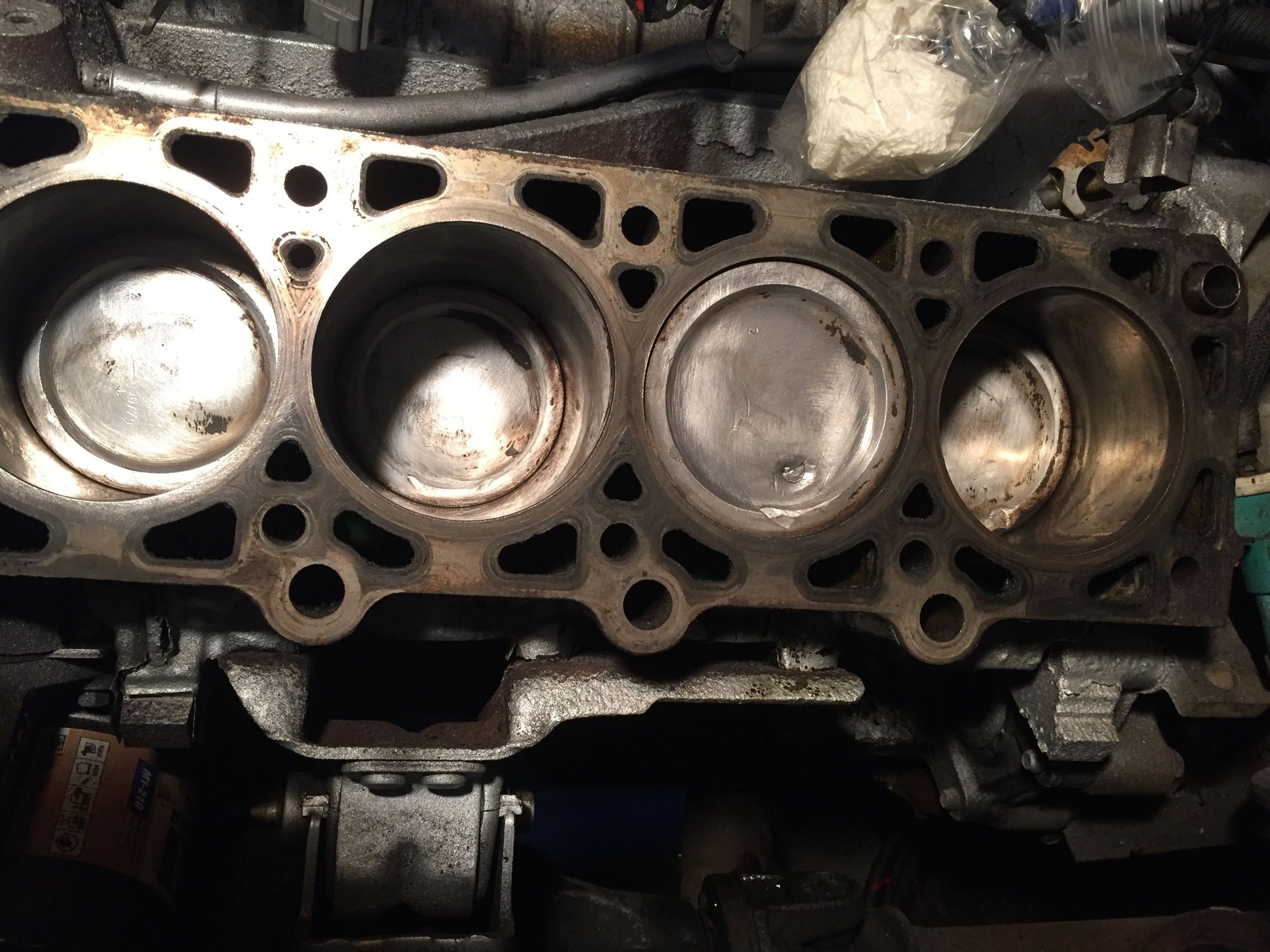

Here is pic of the cleaned up pistons before I put it all together. I cleaned the pistons up the best I could.

you can see #7 has a dimple closer to the outside of the piston as well as some scaring on the outer edge. #8 is the scaring on the outter wall of the piston.
The sound and the pics lead everyone on that page to think the wrist pin, rod and or bearing, piston underneath more than likely got damaged.

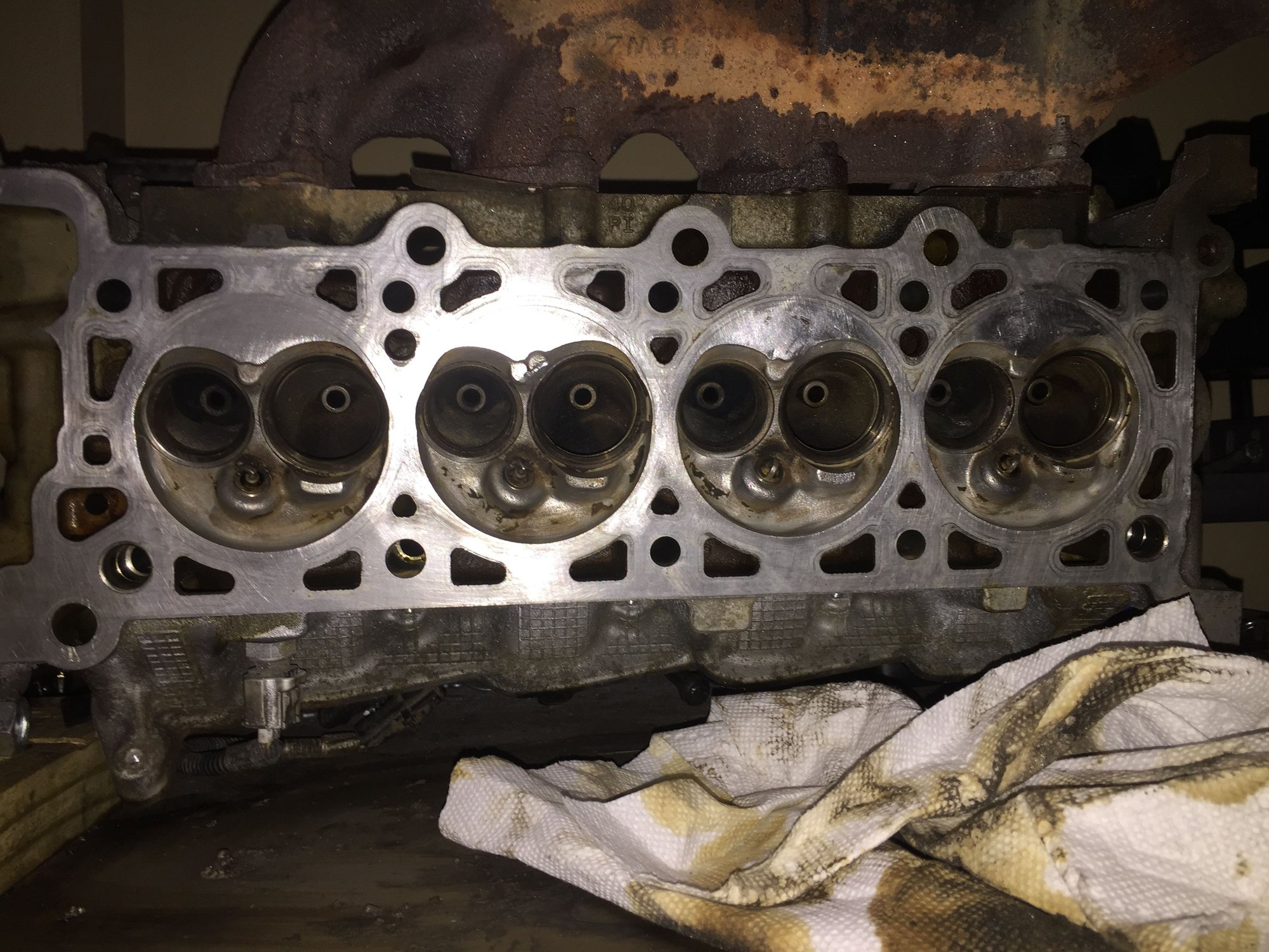

Yes it. The 4 exhaust valves were toast. I replaced all 8 valves and seals. Lifters came out and I put them back in, did not replace them. I checked the valve guides and they appeared to have no cracks. Head had a few marks and I smoothed those parts out as well.

Honestly...even with all the damage as anyone can tell in the pics above I was leaning towards a lifter. I somewhat recall trying to compress the top of lifters when one or a few fell out while working on the head. my fingers couldn't/didn't compress the top. So perhaps they are stuck...

You won't be able to compress the "lifters" with your fingers and the engine may run rough for a few minutes after they have been out. On my Expedition that ate the helicoil, it ran rough as the lash adjusters took time to pump up, but it eventually smoothed out. Here is the damaged piston. It ran perfect when I put it back together.
If that's a rod knock, it's guaranteed to have shavings in the oil. See if the oil on the dipstick looks like a metallic paint job.
