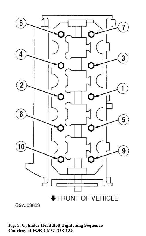

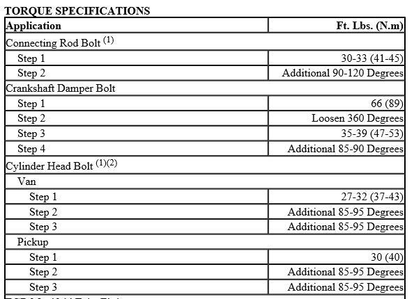

Any good tips/tricks on timing or install of head bolts torque specs and what order to tighten etc..? I've always heard you start from the middle out to tighten and reverse order for loosening.

Please don't take this the wrong way, but if you are 3 hours in and the intake is still on, you may not have the technical skills to complete this job properly. MLS headgaskets need perfect surface preparation. The fact that you had to ask about torque sequence worries me. The head bolts are TTY (Torque To Yield) and are only designed to be used once. They are torqued to a spec and then rotated a certain number of degrees.

Thanks for posting the directions up. I took a lot of pictures for routing of lines etc...Some of the bolts are hard to get at like in the back or the powersteerting brackets bolts at the bottom.
I knew the bolts where only good to use once. I have a new set to arrive today. I asked about sequence as I've read and heard many times that if you just start unbolting the head bolts it can damage the head as one side would be under load etc...
I followed the link posted above and placing the crank at 12oclock before removing the chains is that just to get the pistons low enough so when the chians are removed the valves dont connect correct? My manual indicated when reinstalling to put the crank at 6oclock and the cams at 90% based on the head area. That seems easy enough.
