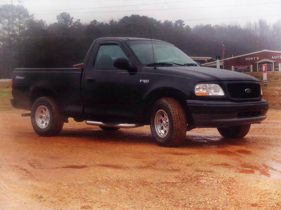

Thanks for the reply. Your truck looks great! I'd probably like to retain about an inch of rake. It's still a work truck and it still hauls things so I figured a 1/2, 2/2, 2/3 or a 3/3 would be ideal.
I might have to take my dads truck for a spin. Mine came stock with 255/70s, his door jam says 235/75 I think.
As for wheels, lightning wheels are something I'm looking at.
Here's a picture-
