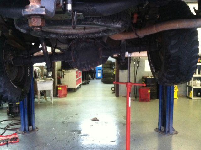

One side at a time, I relieved tension from the leaf by lifting up the axle (I used a pole jack)
With the spring relieved I used a 21mm deep socket to back off the u-bolt nuts on that side, not all the way! just enough were the u-bolt can be moved slightly at the axle tube. Huge hammer just lightly beat the leaves back straight and added my 2 plates, 2 bolts, 4 washers, 2 lock washers and 2 nuts.
-I placed them where I thought I would achieve the most stiffening. 1 at the rear bumper side on the 3 leaves, 1 just past the axle on all 4 leaves forward of the axle, and I moved the stock clamp back on to the 3 leaves forward of the axle.
let the pressure back down and mine came out like this
