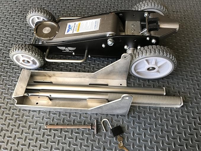

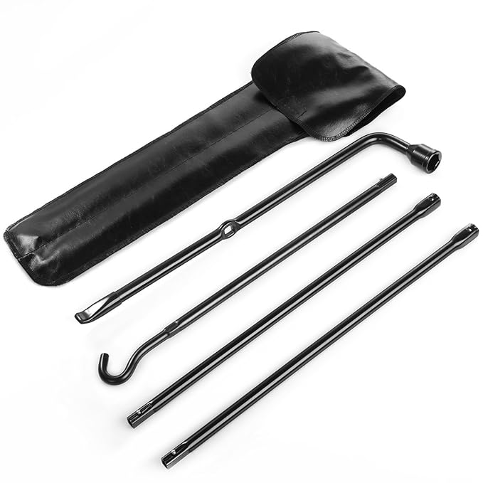

https://smile.amazon.com/DEDC-Premiu...ords=ford+jack
Roll over image to zoom in
DEDC Ford F150 Tire Tool Kit Premium Spare Tire Tool Replacement Kit Include Bag Spare Tire Tool Kit fit for 2004-2014 Ford F150
by DEDC
5.0 out of 5 stars 6 customer reviews
4 answered questionsPrice:$28.99 FREE One-Day
https://smile.amazon.com/Eagle-Wheel...ad%2Bjack&th=1
Click image to open expanded view
COOKE Pro Eagle 2 Ton Big Wheel Off Road Car Jack, The Beast, Off Road Racing High Clearance and 4WD Vehicle Floor Jack (2 Ton, Black, Big Wheel, With Mount)
by COOKE
5.0 out of 5 stars 1 customer review
7 answered questionsPrice:$529.95 + $24.95 shipping
Or build a jack.
