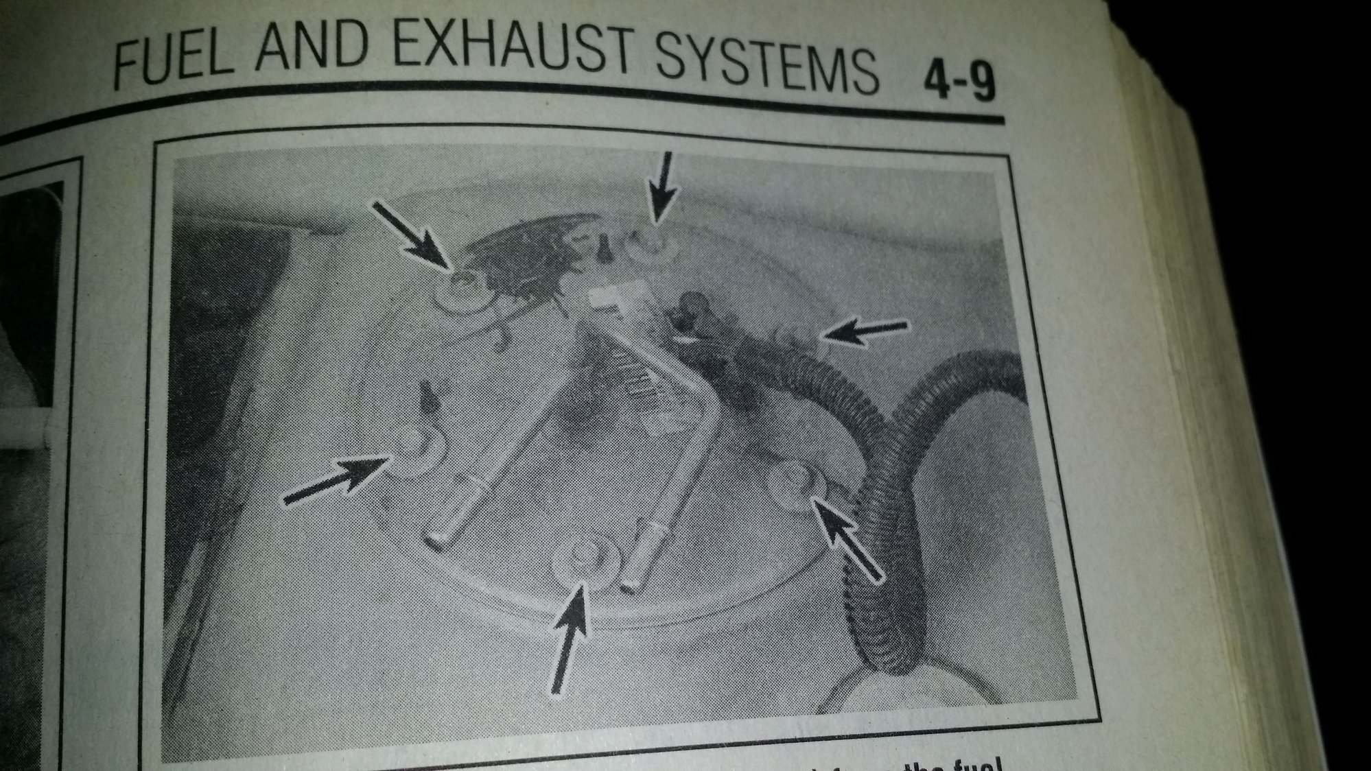

Is there a small harness from a relay attached to the frame to the pump that could have a short in it? I don't think it is the pump itself or the "wiggle" the wire wouldn't cause it to fire back up! It is really strange. With winter around the corner where I'm at, my other vehicle doesn't cut it...

This is the harness I am referring to. Sorry for the pic quality, it's from chiltons

There is a relay under the hood which is hot when the key is on and grounded by the PCM. There is also an inertia switch, but no other relay to that harness.
I'm still a bit confused though... So you turn the key and the engine cranks, but doesn't start. You go back and wiggle the wire and then you hear the fuel pump run? The fuel pump should only be energized for about 3 seconds without the PCM detecting that the engine is spinning from the cam and crank position sensors. If yours runs any time the key is on, someone modified it.

correct, when it starts I can hear the pump "energize", when it doesn't, I do not hear, wiggle the said wire and fires right up. Lights, dash everything works just doesn't start. Wiggle the wire and all seams good. Like said, confused why it doesn't do it and die driving down the road, only after it sit for awhile. I do not hear while it is running, just startup like you said, maybe 1 or 2 seconds

I suspect the harness has an intermittent break or short in it. Once the engine is running, there's probably enough residual pressure in the fuel system to keep it running even if the fuel pump loses power for a few seconds. That might explain why you don't notice it while driving over bumps. Just a guess. Looking at videos posted online, you may be able to disconnect the harness without completely dropping the tank. Good luck.
