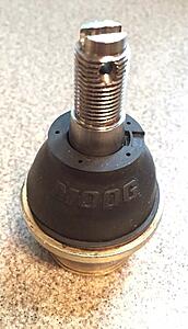

Moog redesigned their lower ball joints. The new boot is internal and holds up a lot better.
Old style:
New style:
Learned this when I order new lower ball joints. Rockauto shipped one old style and one new style. I found another new style around town cause I wanted them to match.

Yep...the bottom pic is the same as the ones I rec'd. New style.
