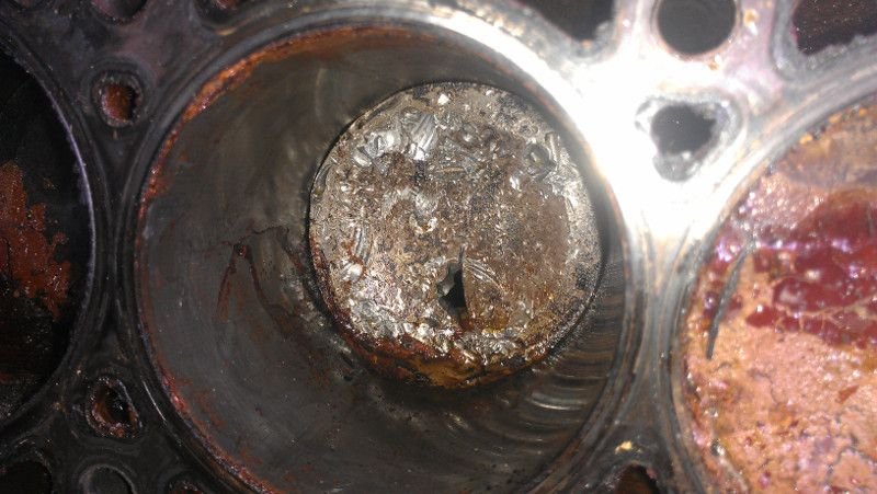

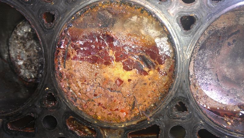

When I got the valve covers off, I saw that one of the roller followers was off the valve. I didn't even see the valve stem. I found the roller follower, in pretty good shape, along with a broken spring. Once I got the heads off, I saw the extent of the damage, as seen in the pics below. It seems, when the spring broke, the valve fell in the chamber and got chewed up, poking a nice hole in the piston along the way. What I'm holding in the pic is what was left of the valve. You can see a bit of the valve embedded in the chamber above the open hole.
From what I can see though, the piston walls don't look too FUBARed. I'm thinking about yanking the block next and putting in a new piston. At the moment, the crankshaft won't even turn. I'm assuming its from the rust buildup. Hopefully, its not from bits of valve wedged between the piston and the cylinder walls.
I'm thinking about grinding down the combustion chamber, where it got beat to hell, to smooth it out, getting a new valve, guide, seal, and spring, cleaning everything up, and relapping all the valves. From what I can see of the beat up chamber, it looks like valves could still get a good seal. I'll also have the head planed if it turns out to be warped. I haven't checked yet. The head gaskets were fully intact. That makes me wonder how the coolant was getting into the oil so easily. It was a full on water fall and mocha latte fest when I pulled the oil pan plug some time back.
My suspicions are that the heater core leaked, the engine overheated, the heads warped, and then the heat caused the valve spring to break, causing the other damage.

That's a mess - I'd look for a junkyard engine or a reman.

Second, that engine is not worth rebuilding. Junkyard or reman as stated before. Find yourself a PI 4.6.
