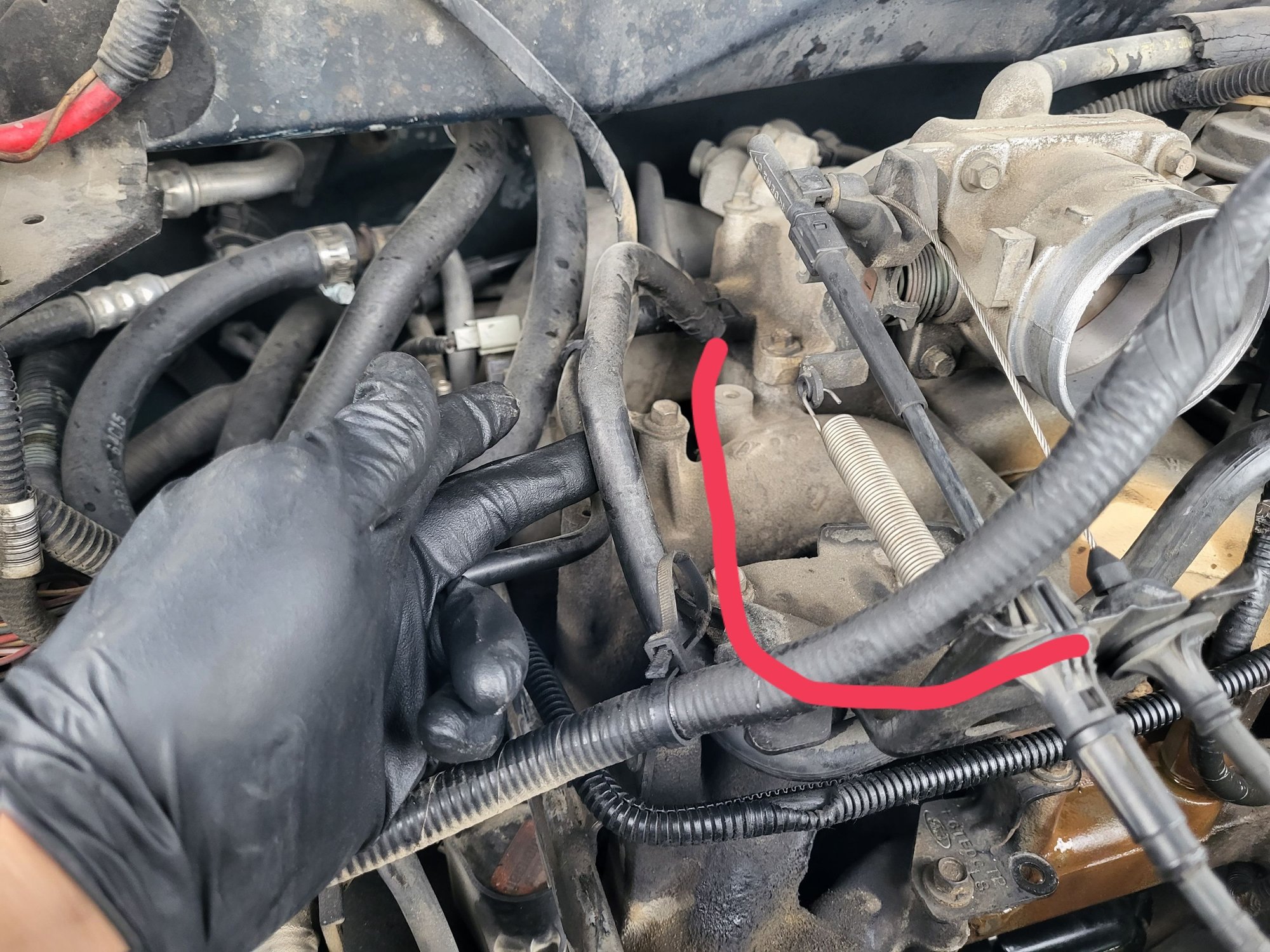

Leak on a 2 inch valve above the Crossover Tube above the alternator
Thats it right there. The alternator is removed. It's wet. Not sure if it died cuz it was it's time, or it died because it's been getting wet from the small j on the valley being damaged. I can't find what it's called. So far I've learned it warms up the throttle body to burn fuel better. And it's attached to the Crossover Tube.
It has a hole on the j style tube. Right on tje corner
This the hose attached to the (valve) with the thin j style hose attachment
This is a pic i found online. The closest to being similar to mine. Cant find a thing anything else
Runs to the back of throttle body
Its steel so i ended up welding it. Its steel. Worth a try no?Other option was find it at a junkyard. Couldnt find the single part online. Read that id have to get the whole entire manifold in order to get it new. Autozone didnt know what the part was either.
