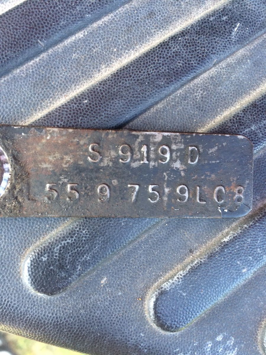

What's your axle tag data? Everything, please. If the parts store matched up tag numbers you should get the right one this time.
Old May 28, 2015 | 04:06 AM
postalwack's Avatar
Joined: May 2015
Posts: 3
S 919 D<br/>L55 9 75 9 LC 8<br/>

I see that the axle diameters are indeed different but I did find that Rock Auto has Dorman axles that are 8.8 diameter and 34 3/8" long, 34 spline to fit with 9.75 ring gear. Axle code 919D.
Part #630241 for left side
Part #630219 for right side
They may have others but that will get you started.

Ford part numbers:
Left: F75Z4234MB
Right: F75Z4234MA
The 919D is the key.
