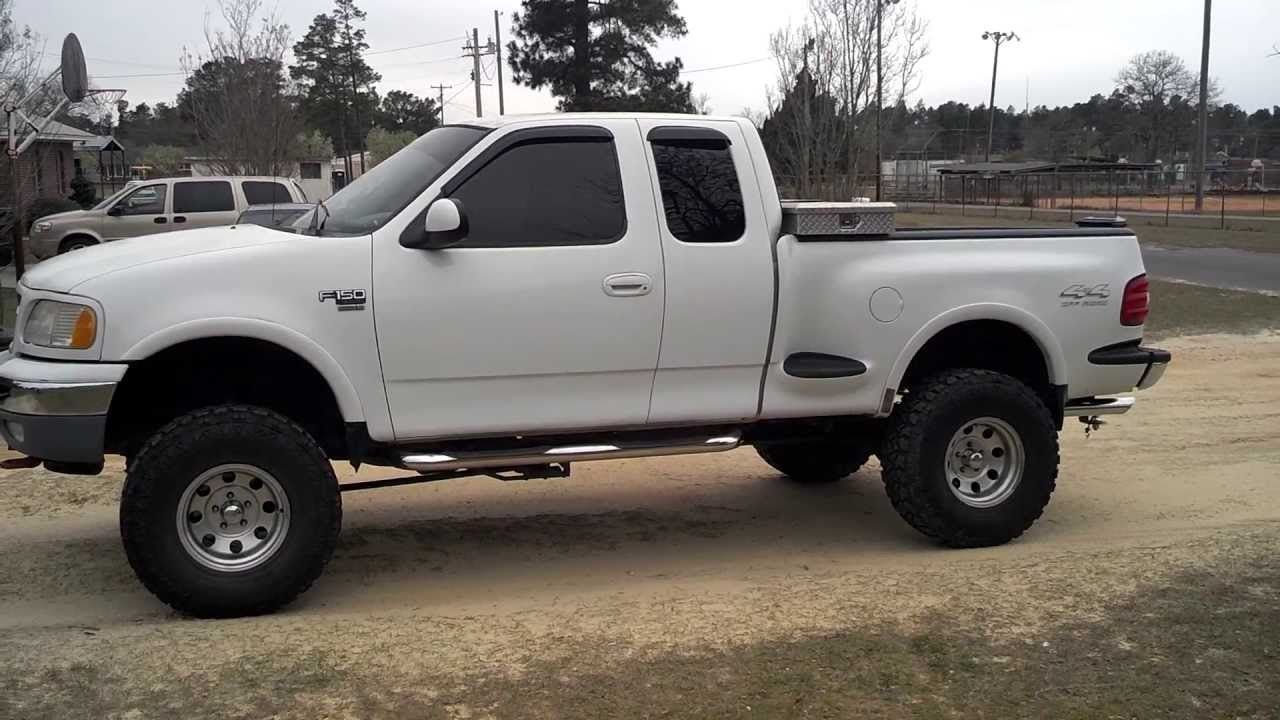

i have a 2002 f150 supercrew short bed. i really like how the step side beds look on regular cabs and supercabs. i have never seen a step side on a supercrew. does anyone know if the bed is the same length as the supercrews and if it would bolt right up and look like the factory did it? maybe if someone has a step side could measure the bolts and bed length so i could see if it would fit my truck. Im really curious if this would work and i would attempt to find a step side bed if i knew it was the right size. also the length from the back of the cab of an step side to the wheel would be helpful.

Step side beds are 6.5', pretty sure your bed is 5.5'. It wouldn't work without some heavy fabbing as you'd need to lengthen the frame, relocate the rear axle, fab up some mounts, etc.

Someone on this site has put a 6.5' bed on their supercrew before, but I remember it being a pretty lengthy build.
You could modify the stepside bed to shorten it out and put some new mounts on it, but still not an easy process to get it to look anywhere close to right.
