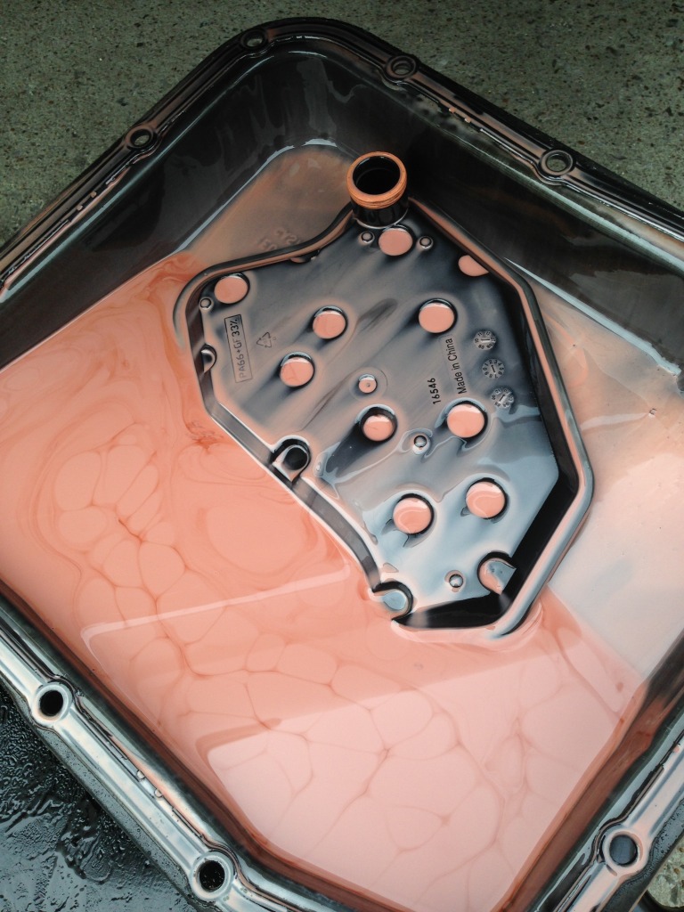

Here's some carnage from today.

I did have some concerns. I performed the DIY flush method as outlined many times on the forums here, and the fluid never really came out looking new. It was certainly much redder than in the picture, but it still looked milky...
I used up 14.5 quarts, but then I had to stop because I ran out of new fluid.
Because this is coolant mixed with transmission fluid, does this mean I just need to run more fluid through the transmission than normal to complete the flush?
Yep - likely much more.
Go find some cheap Mercon V (Wallymart Supertech brand is fine).
Woon't do the pan drop/filter change until it runs clear.

This MIGHT be one of the times I'd actually recommend a flush and not just an exchange.
I'm gonna lean heavily on the MIGHT because this transmission is olllllllld, and I'm worried about the flush horror stories, even though I've been changing the fluid regularly.
I really would like to see if I could wring at least 275,000 out of it tho.
I'd hate to imagine that a routine failure like a radiator would render the truck undriveable in such short order.
