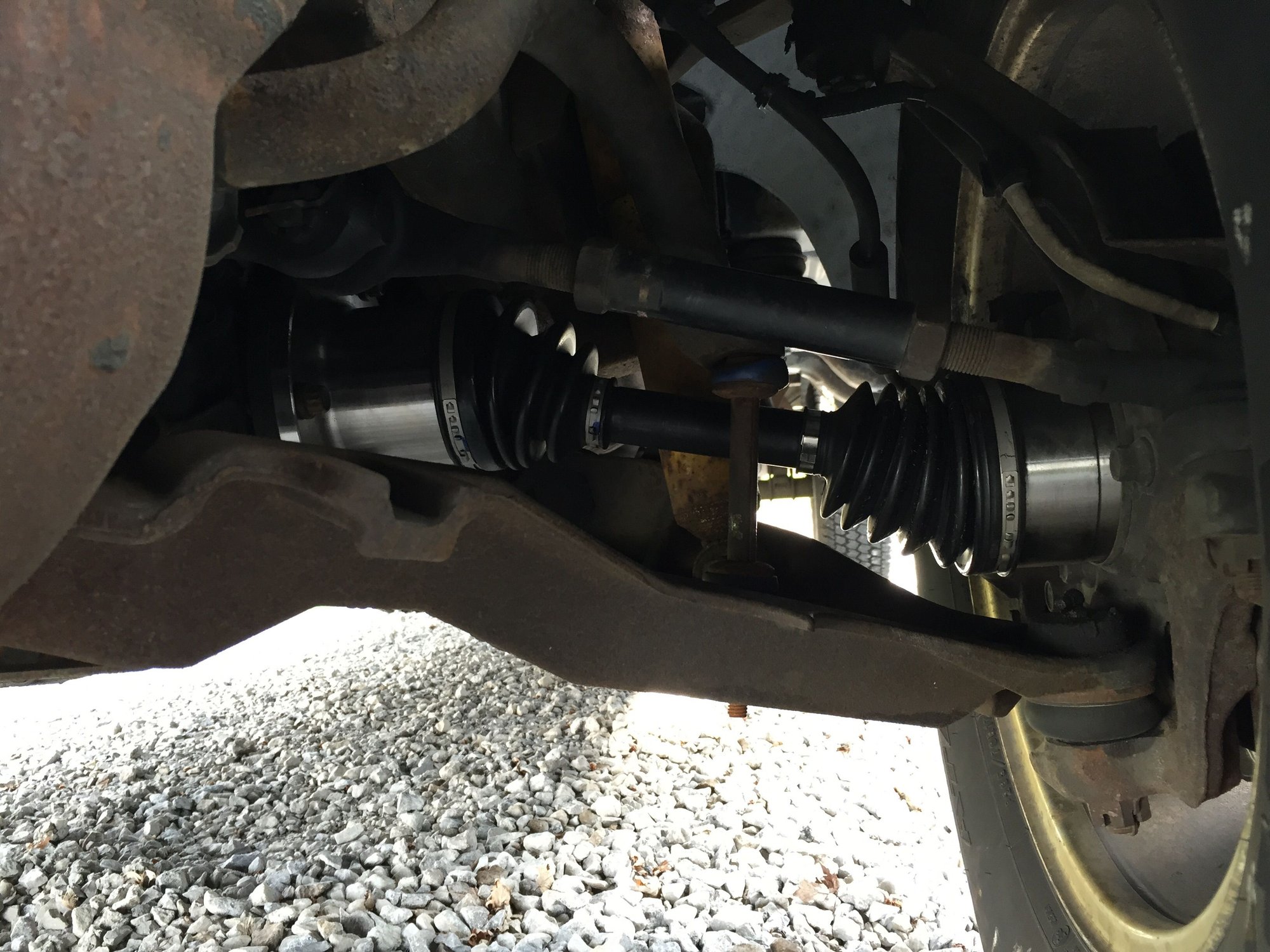

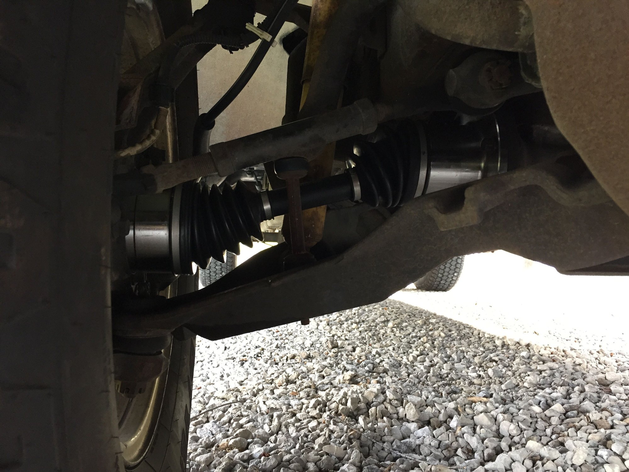

Exclamation Update
Found this today while changing the oil and snooping around.
CV shafts are just over a year old and the boot is tore and both make this awful noise. Driver side sounds a little worse though. This can't be normal...lol. Oh and the CV shafts are aftermarket new from Advance Auto (lifetime warranty) thankfully
Hope my youtube link works👇

Yep, good thing you do have a warranty. Aftermarket halfshafts are junk compared to a reman OEM.

Ok I changed out both CV shafts yesterday and to my surprise the noise is still there. I thought for sure this was it. Back to the drawing board
Old Apr 19, 2015 | 11:14 PM
those angles look like the torsion bars are cranked up
idler/pitman are known to thump but its usually a single thump on decel, and a thump on accel and the tires slack out or slack in
ball joints, sway bar end links

Angles do look a little off but the ride height is completely stock. The truck sits up higher in the back to. I've never had any suspension issue with any other ford truck or expedition ever. This is just baffling
