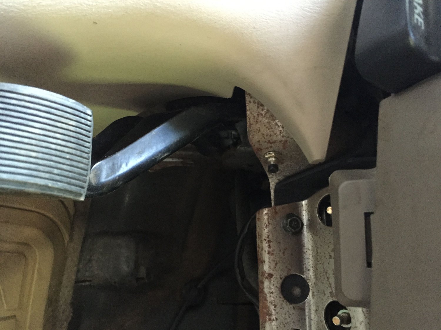

So this is the sticker on my driver side window.
I found this switch above the parking brake pedal.
If I hold the switch I can start the truck without the FOB, but I had no luck reprogramming\disabling the alarm. I put the key in and turned it to the ON position just before starter engages. Then I held the valet switch for 5-10 seconds. Nothing happened to the LED on the dash and the truck would not start without pressing the FOB button.
