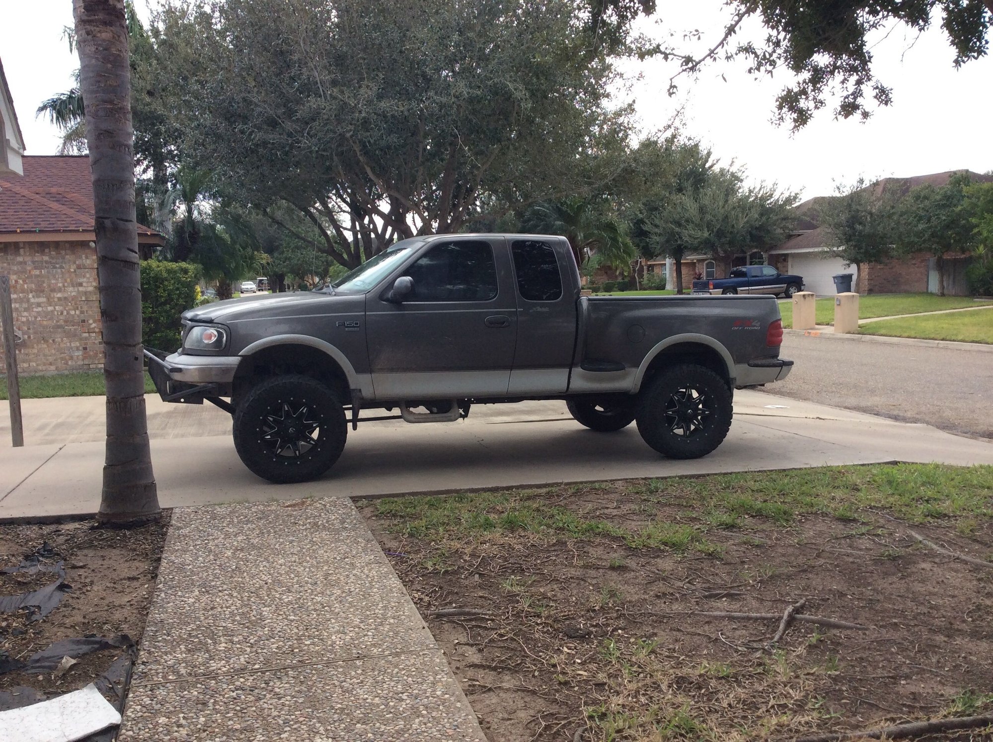

Hello, I have a 2002 ford f150 lariat fx4 and the engine (5.4 triton) won't go past 3x rpm's no matter how hard I press. The tranny shifts at random times and mechanics had no clue and so I wanted to swap out the whole thing, I've got about 10,000. I was looking into getting the same engine supercharged but I need help picking the right transmission and axles, I'm looking into making it kind of a prerunner, I already got KYNG shocks and new leaf springs. With upgraded control arms and sway bars. Just need the power to get her going fast off road.
