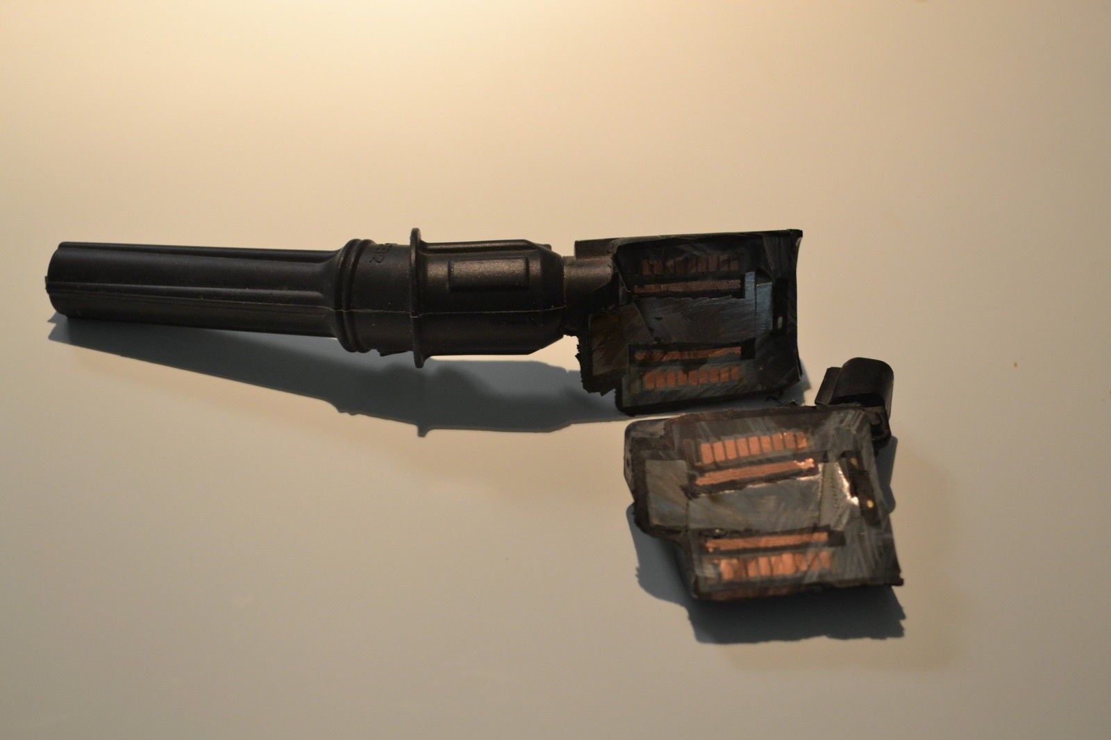

Let me expand on coil manufacturing just a bit so some understanding of the issues that can develop in any coil.
Provided is photo of a cut of the bobbin and wire winding that is normally used.
The wire is normally Enamel coated for insulation for many turns in the space provided on the form.
Tension of the winding as wound during the process is important.
If the winding is too tight, expansion from the heat the coil lives under can cause the Enamel coating to rub through causing shorted turns.
When this happens the magnetic field developed during current flow is greatly affected or reduced. The result is lowered high voltage output and possible misfires especially during OD when EGR is called to operate. This causes the mixture to go Lean from exhaust 'dilution' from the designed in effort to cool combustion temperatures and reduce NOX emissions as specified by the US EPA..
The shorted turns can cause coil overheating, low coil voltage, loss of PCM drivers resulting in misfires and 35x codes for total failures that result.
Otherwise intermittent misfires as the coil faults then clears from temperature changes.
Given the tremendous range of heat cycling a coil goes through repeatedly, the winding moves causing shorts and wire fatigue lead breakage at the points of connection to the plug area in the outside form.
The quality and care of manufacturing determines to a large extent the life of coil.
Coils are considered a maintenance item as well and not meant for unlimited life.
IMO, if the coils were to be provided a housing and duct work and forced cooling, their life might be greatly extended.
I use a fan controlled transmission cooler that senses the temp at the radiator input from the transmission.
This also senses the temp in the engine bay during shutdown.
During hot ambient temps at 90 and above, the small fan comes on during low road speed towing and after engine shutdown to limit the engine bay peak temperatures because the fan has power full time to uses when called for.
Since adding this feature my coil loss has been non existent for more than 100,000 miles. Can't prove the connection as an absolute but with min. other issues under in the engine bay from heat it sure looks like the small fan has had an effect over the long term.
During high temps the small fan will run an average of 5 to 7 minutes after engine shutdown with it's thermostat set at about 190 degrees.
I am now heading for 232,000 miles on an 02 4.6L with no sign of engine issues yet.
Good luck.
