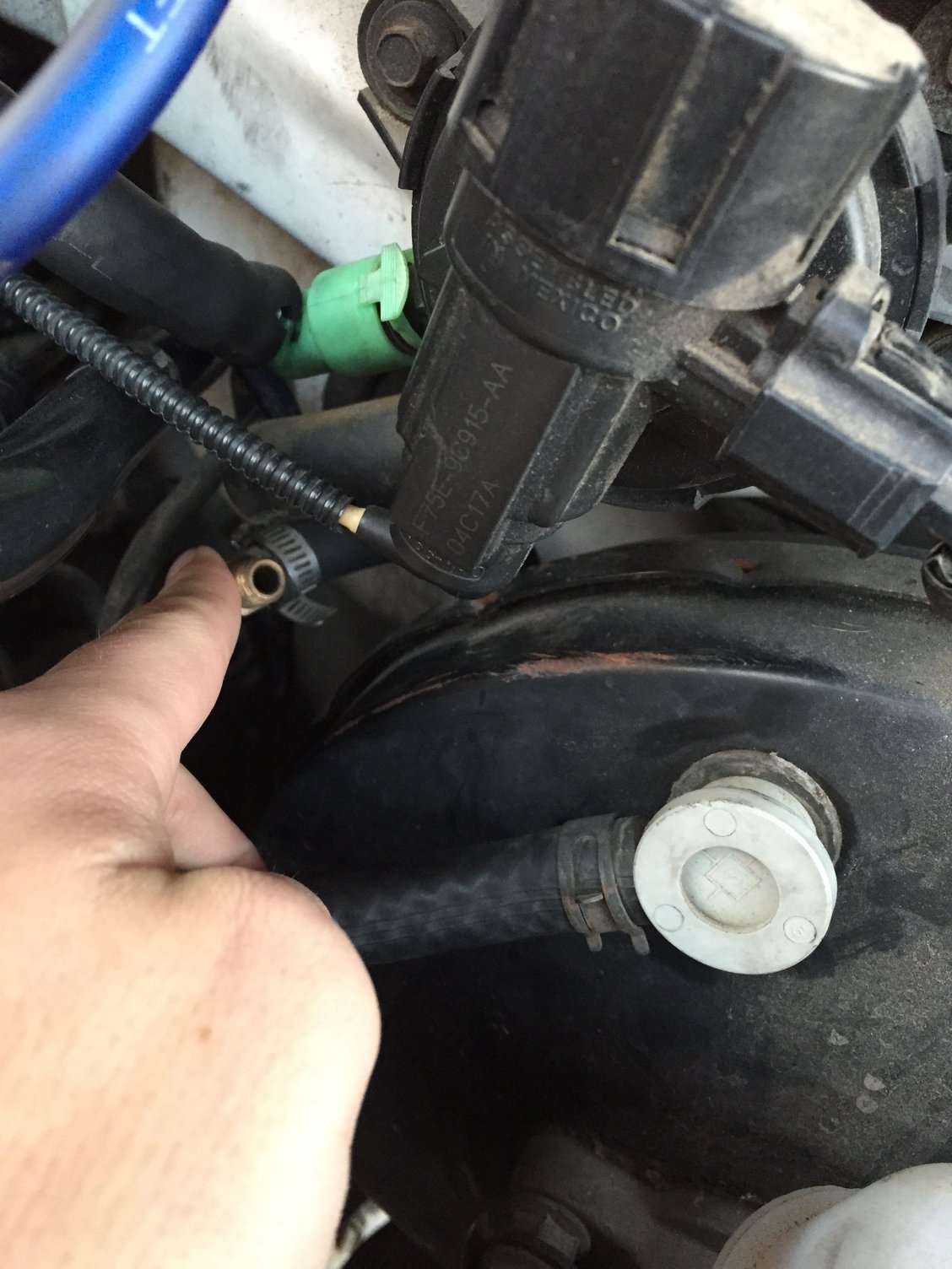

Hello there, I have a 1997 f150 5.4L and recently the check engine light came on. Took it to Firestone and they told me that the engine is running too lean and it was intake manifold gasket leaking. This is he third vehicle they said that to. My dad took a look at it and he saw that the vacuum hose is collapsed and there was a hose that was just hanging there. We reconnected it and at idle it's rough, and shakes real hard as if it wants to die but when you give it some gas it smooths out as if there's nothing wrong. So before I rip out the top end of the motor to replace the intake manifold gasket, could the problem be the vacuum hose or something else?
The vacuum hose
The hose that was hanging there that isn't secure

The collapsed hose does indeed need replacing. Vacuum has sucked it closed.
The open ended hose may belong to a port on the same hardware below the Green connector. I can't quite be sure from the angle of the photo but that connector should be White. Is it there?
Find the proper home for that hose, replace the one with the green connector, then lets go from there.
While your at it inspect the hose from the passenger side of the valve cover to the rear of the intake. At he rear there is a Rubber Ell that very often goes soft or hard and admits air.
This fault will cause rough and stalling idle after the motor warms up.

The vast majority of the time the lean codes are vacuum lines usually PCV system. The elbow at the back of the throttle body is the usual source.

Any input on how to see the elbow behind the throttle body. I took the truck to a shop where it was inspected OKed . Before I tear into the manifold gasket on a 2002 110K truck ...how do I see it myself? Trust with verification.

It's tough to visually see behind that vertical manifold without using a mirror and light.
The hose pulls crank case fumes from the PCV back into the engine intake.
The fumes softens the rubber and eventually sucks a hole in the soft part.
This becomes an air leak.
Assuming all other hoses are in their proper place and none of the modifications I see listed are causing an issue, hopefully there is only one air leak and not more than one to confuse.
A way to test for a leak in that area is to uses a flammable spray cleaner sprayed in that area with the motor running.
If there is a hole, it should pick up some of the spray and change the idle speed.
Another way to check for a leak with spray is to look at the short tern fuel trim tables with a Scanner for a change as the motor picks up or senses the spray.
Best I can offer for now.
Good luck.
