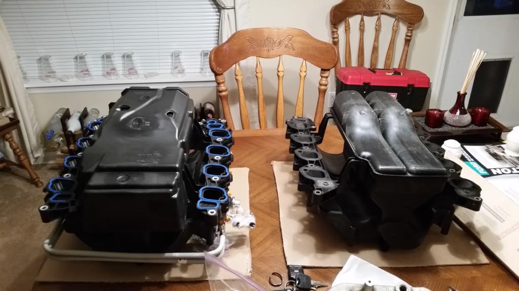

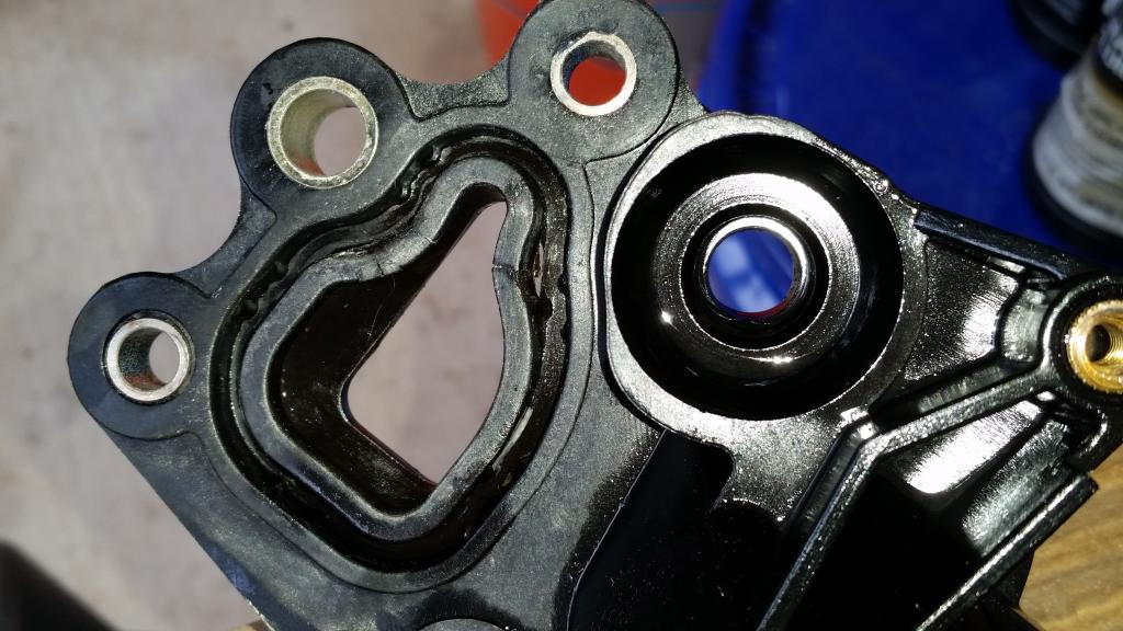

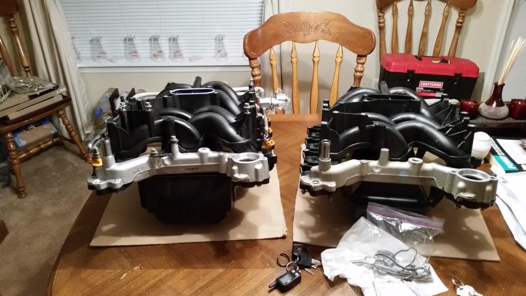

I ran into it while replacing a front cover a few months ago and replaced mine that was cracked but not leaking yet. I believe they swapped the styles from aluminum to composite in the 99 to 2000 year and then updated again. I had the older style composite.
This is where they crack in the cooling crossover part:
New style/updated one on left
Again new one with larger valley stuffer on left:

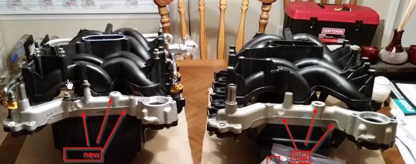

Thanks for your post, that was exactly what I was looking for.
The only differences I could find on the top side are the following. The underside I won´t see when I looking under the bonnet.
Are there some more details to identivy the old vs. new manifold?
Codes, Identnumber, Inprints....
Cheers Ben

I didn't notate any other differences or stampings. The part number I ordered was 2L1Z9424A. You will know looking at the front of engine and into the engine valley if its the new style with larger valley stuffer in it.Im currently in TN on a project and wont be back to NC to actually look at truck to find any other markings for a few weeks.
