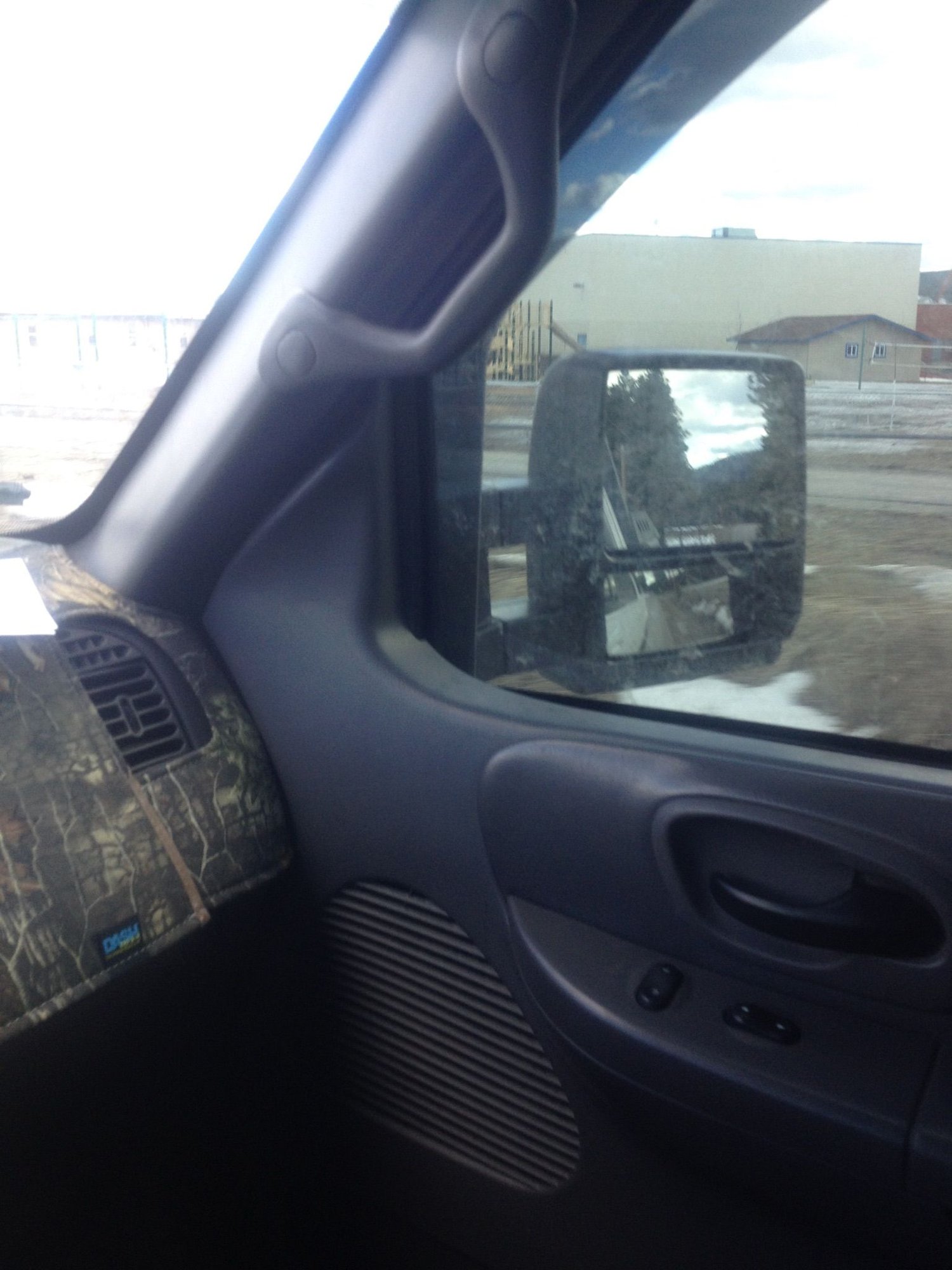

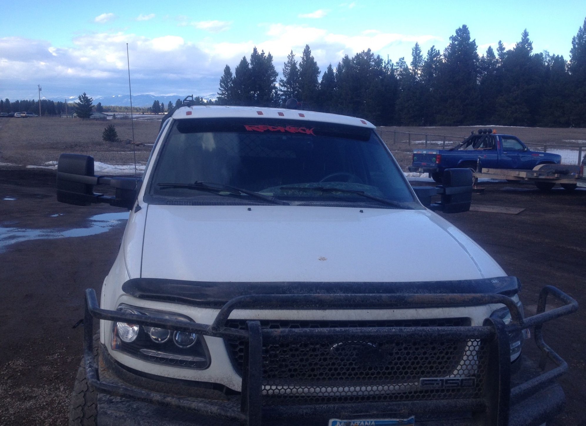

Originally Posted by 2002F150SuperCr
Mirrors look nice man, but you can post all your images into a single post instead of doing them all seperately..
1998-2002 ford expedition tow mirrors fit the 2001-2003 supercrew perfectly
I contacted AM parts website they have tow mirrors for 1997-2003 expeditions but they said it has heated mirrors and puddle light and if my truck doesn't have that options the plug in going be different and the mirrors won't work properly is that true?
Old May 6, 2015 | 01:38 PM
2002F150SuperCr's Avatar
Joined: Mar 2015
Posts: 86
should be the same connector. you just won't have the extra wires for the heated and puddle. you could always wire up the heated and puddle lights. when i bought my tow mirrors from am auto they didnt have heated or puddle.
