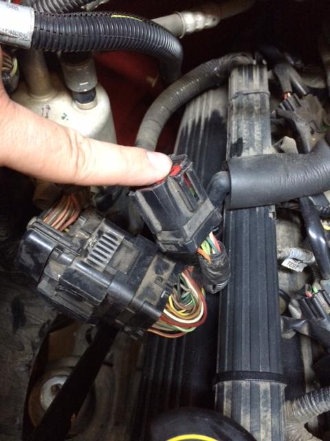

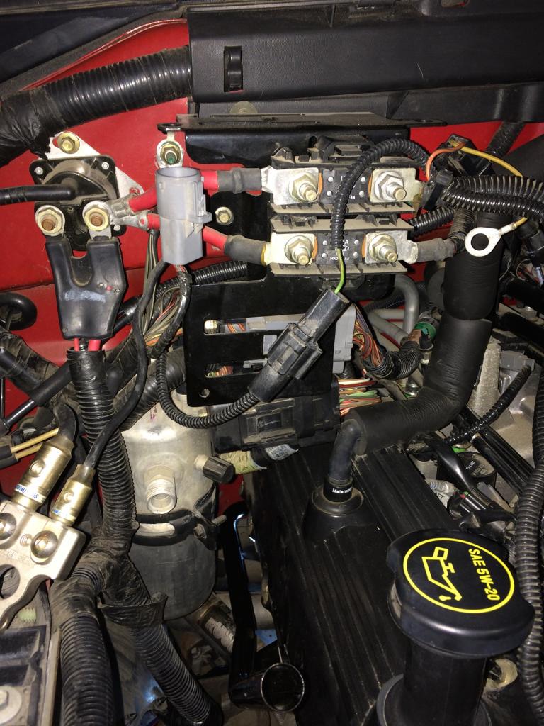

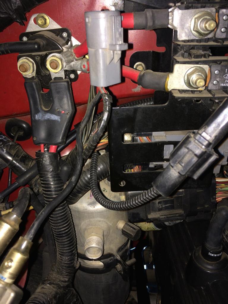

What i ran into is the ford lightning engine harness has two plugs that go into the pcm harness. The original 4.6 only allows the one 42 pin plug and not the 16 pin.

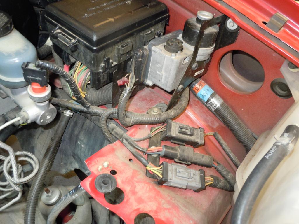

The ford lightning fuse box and pcm harness doesn't plug into the fuel pump harness beneath the cruise control module and i do not have the lightning fuel pump harness or ABS system

I am completely stumped and some advice on what i need to get this thing running with the stock lightning engine and 4r100 trans

I have never had a 4.6 truck, so I can't help you with wiring, but I can tell you the truck won't run because of PATS. You'll need to have the PCM custom flashed to remove PATS.
I know the 5.4 and the 6.8 both have two large plugs like you have your finger over in the first pic.

Correct, when I first read your post I thought you had the Lightning PCM also which does have PATS. I just reread the post and I guess you plan to use the 4.6 PCM. Again, I have never done a 4.6 anything, but you'll need to have the PCM flashed or replaced for the 5.4.
