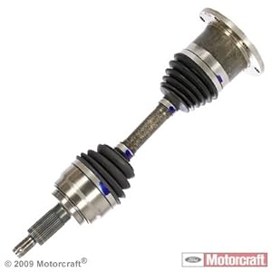

Originally Posted by jbrew
Trans axles are the same as half shafts.
Originally Posted by Red Ford
I've got no idea what that means, is this tieing into my torsion bars?
I think jbrew is talking about these things.
Although typically, "transaxle" is used to refer to a driveline component that houses a transmission and differential in the same housing, a setup common among many FWD cars with transverse mounted engines... or high performance sports cars, go figure.
CV axle, half shaft, transaxle... same stuff.
