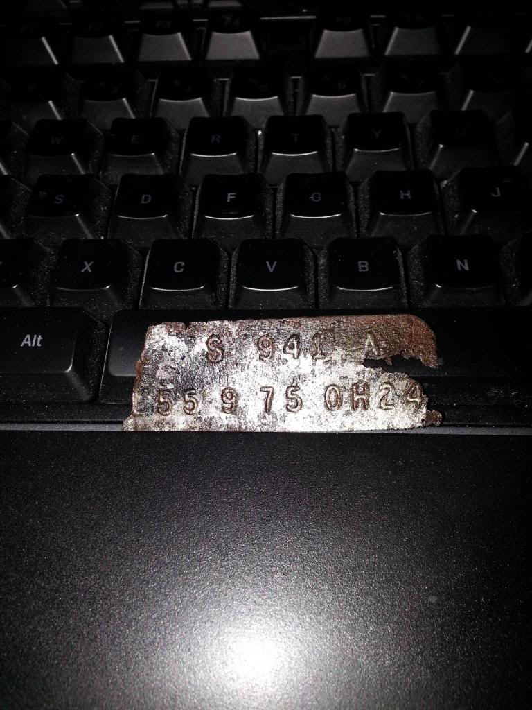

can somebody decode this tag for me? it was broke off to what looks like a "L" so im thinking it was a "3L" it came out of a 2001 ford f150 4x4 4.6 L.

9.75" 3.55 limited slip. It would have to be out of a 5.4.

No,Actually it was a 4.6..But thank you for the reply.I had a local mechanic install it due to I work alot. So I was doing some research on it because it has alot of surface rust on it and im going to replace the rear diff cover.

H9 is only the ratio. The 9 75 indicates 9.75". I have never seen a 4.6 or 4.2 with a 9.75" axle from the factory, they all came with a 8.8".
This is a 8.8" axle:
This is a 9.75" axle:
Note the completely different shapes.

You had a mechanic swap it out...
So it is likely not original to a 4.6.
9.75" were for the 5.4L
They are swappable
consider it an upgrade
