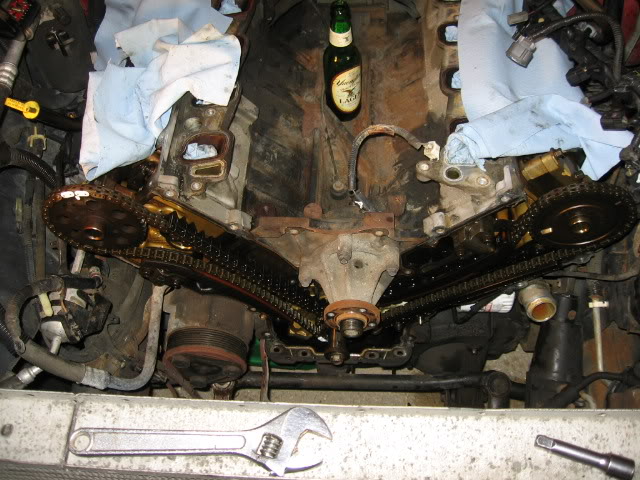

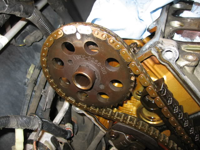

That is how I did my 99. Remarked the factory marked links that were hard to see and marked the gears on the factory cut out mark. Just make sure when you put it back together they are 100% correct. The cam wants to turn and mine kept jumping off a tooth. It took a couple of tries to get it because I didn't use the cam lock tool.

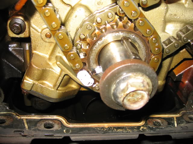

On the cam, the mark lines up between two links. These are both factory marked, just hard to see. The crank lines up in the center of a marked link.
Turn it over until at 12:00 and it should be easier to find them as they should line up.

Here is the cam mark, at the bottom. It will align between the two marked links.
and the crank mark at 10:00 position will center on the single link.
