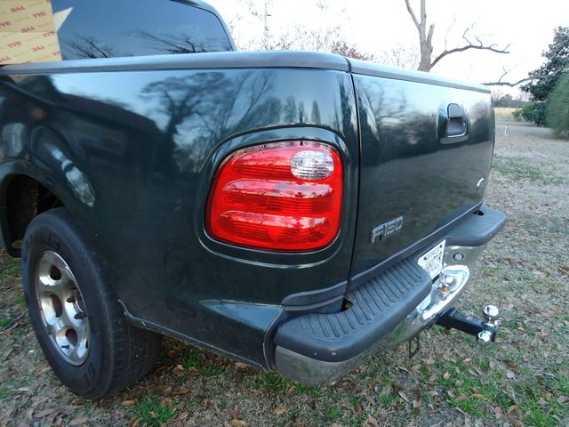

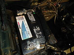

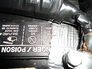

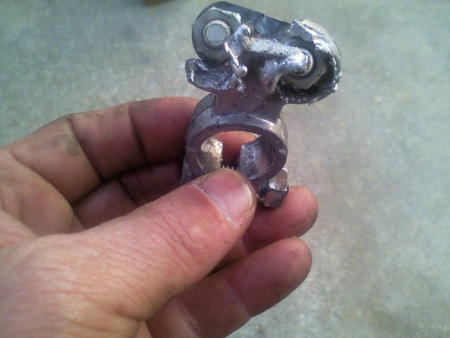

Thanks, and the s**t continues. First, I got a new drivers tail light, the bulb was blown in the old cracked one, only one bolt holding light in, it had an amber bulb (yes amber), and the connector was wrong and someone had taken a wood crew and screwed connector to housing, I changed power mirror switch, have an antenna assembly on the way, rear glass resealed ($75) and greased seat rails. This morning I figured I would drive it to work as a FINAL shakedown..oh, this is classic, now I know why truck would shut off when I slammed the hood. As I was driving down dirt road (thank god close to house), truck and all lighting died and I could smell a fire. I popped hood and positive battery connector was GLOWING bright orange. I doused water on it, recranked truck and went back home. When I came home today and looked, battery terminal was hitting hood and grounded and arced on hood with hole burnt in the insulation. I rewired with new connectors and for added insurance took a piece of rubber mat and mounted under hood insulation, but I trimmed a battery fill cap and was able to get terminal flush with battery and fusible link out the way. NOW when I turn key, gages do not go backwards first, interior lights bright and truck runs sweet..so will try to drive to work again. The radio display fix didn't work, re- soldered resistors, but when I took face off a piece of the GLASS display fell out, so she has stereo with no display, no odometer and I got her a quote to replace windshield ($200), hopefully she will get it Saturday and bring back my baby...thanks guys. Pics

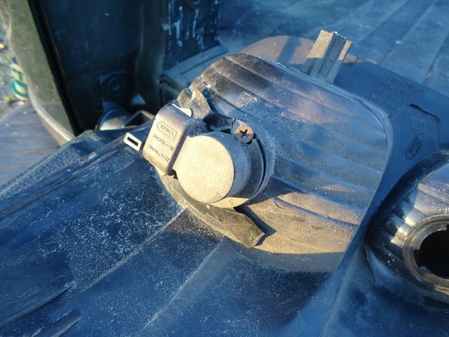

Lol, she still is ex, had to show pic of tail light bulb connector I found in housing with wood screw, I then did a mod to a connector I had that at least screws into the housing. Replaced as well brake pad and power mirror switch.
