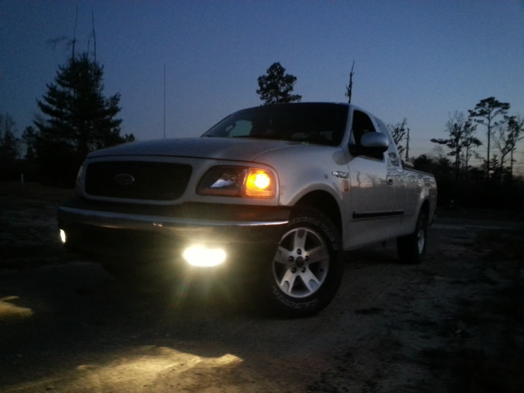

2003 with the V6. Largest repair money was the Rear main seal. I ain't complaining with that being the only significant work done to it in 3+ years and 33,000 miles. 169,000+ and still going strong. And just for the heck of it, here is mine...
