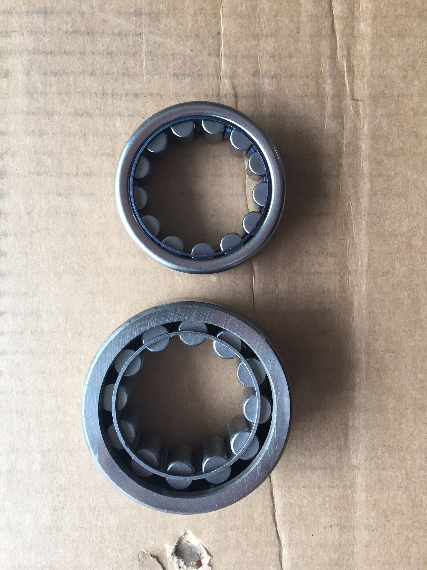

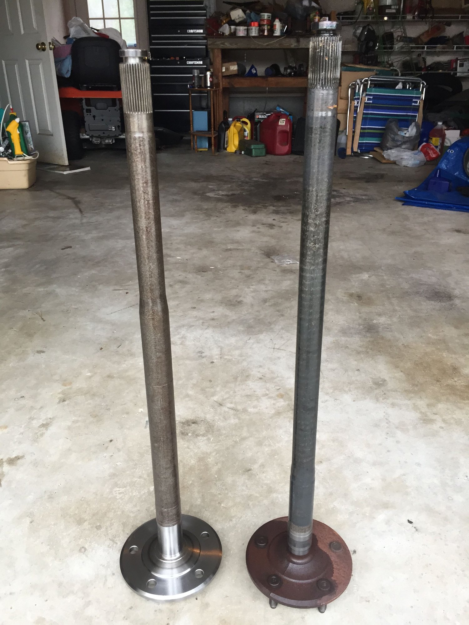

When I ordered a new axle and wheel bearing for my 2002 F150 5.4L I ordered the wrong axle the first time and had to reorder. My truck has the smaller axle bearings, code 919F if memory serves. Here are some photo of the two axles and bearings.
