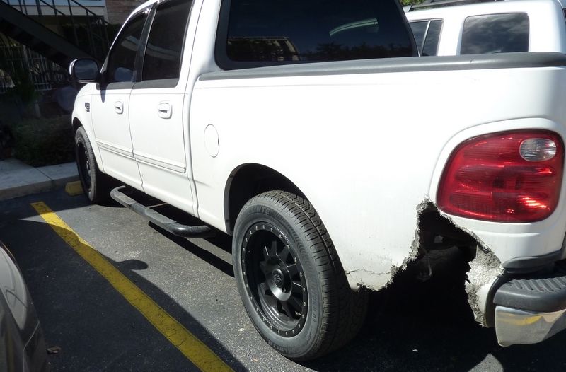

The other day a teenager hit my truck on the left side of the rear end. I would say about a square foot is missing from the bottom.
My question is, do I have to replace the whole bed or can I just replace the panel?
I've been told the whole bed since the panels are fiber glass. Would like an experts say.

Fiberglass? What kind of truck do you have? Pics?

Hi sorry for the delay. Been busy.
The truck is 03 f150 xlt screw.

The hood is actually aluminium, only the flareside and supercrew beds are fiberglass. I would try to find one in a junkyard. They actually unbolt from the truck bed. Nothing but hand tools is required to remove the whole bedside.

Nope. Mine is steel. It might only be the s.crews and the flareside trucks. I'm not sure. As far as the repair, I doubt you can by sperate panels on the bed. I believe its one whole piece.

Check the LMC truck catalog. I'm sure you'll find the panels there.

On your truck that fiberglass panel bolts on. It it not very hard at all. Look into just getting that panel at a yard. If you can find one in the YZ paint code and charge him time and material.

I found a junk yard that is going to sell me the whole bed for 450 delivered to my address.
It is a different color but I'm ok with that cus I was planing on painting the truck anyways.

Yes the panels come off. At the top of the bed side there are like three small bolts (hidden under the plastic), on the back like two, in the middle like another two, and in the wheel well a bunch of small ones.
I'm amazed how simplistic the whole thing seems. So delicate and fragile. Is that why male car enthusiasts call cars “she”...fragile and good looking .
The whole truck bed is held by 6 bolts. Two people can lift the whole truck bed easy.
On the plus side the truck bed that I bought is line-x plus it came with the tail gate too.
