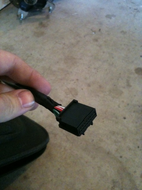

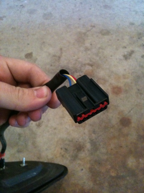

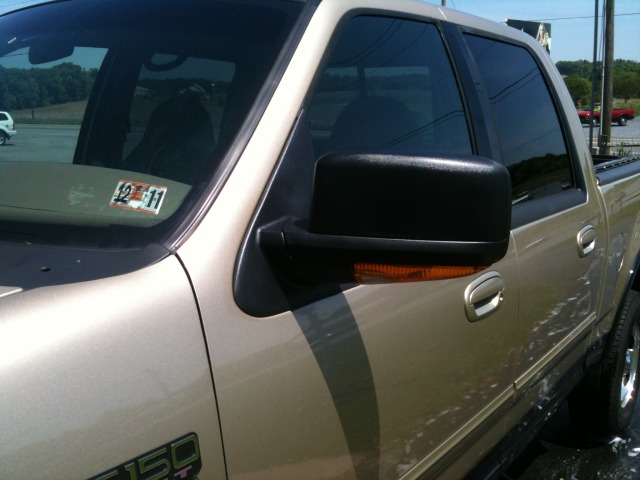

I've done this mod. The bolt pattern is identical, so they bolt right up, but the connection is different. You'll have to wire everything if you want them to work. I cut the ends off of the stock mirrors and replaced the expy mirror plugs for the motor controls and turn signals. To get the puddle lights to work, I ran wires to the interior lights in the door. I have full function, except I didn't hook up the heat. Also, the motor controls are backwards for some reason.
I can help you out with what wires do what if you decide to tackle this. You'll be so much happier with these. I took the risk and tried it because I tow quite a bit, and I could never go back to the stock mirrors.

Stock Connector

Expy Connector
