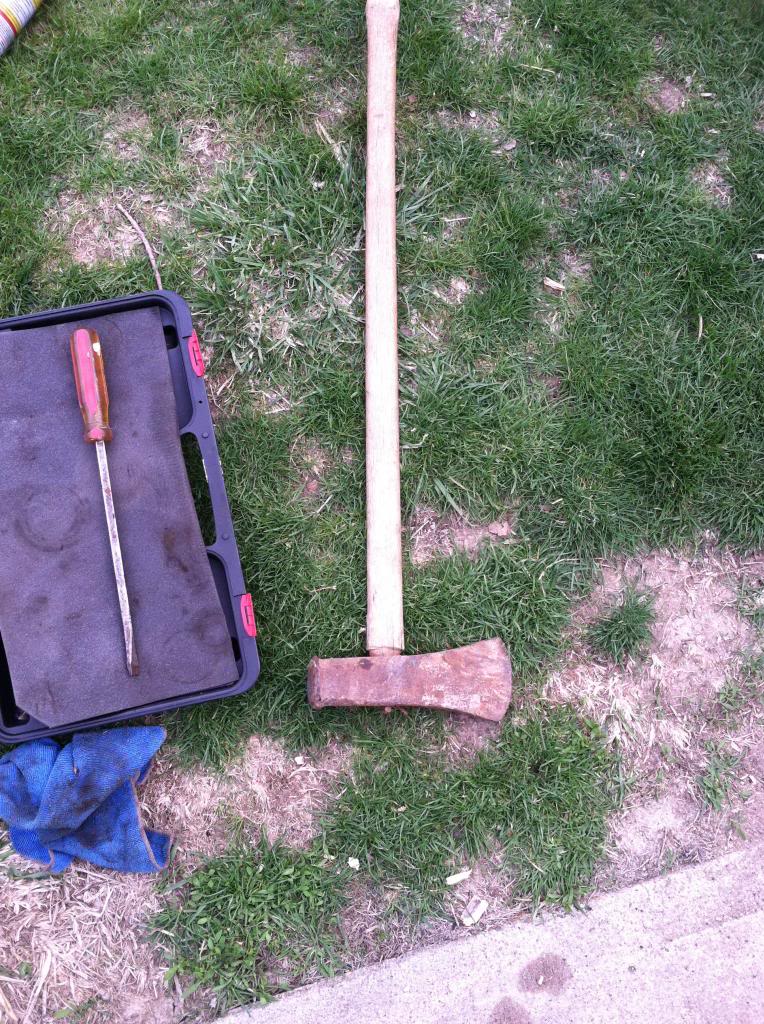

Driver's side now, but I can't get the axle to slide in to allow the knuckle to come down. I've put a jack under the control arm, gone from up, to level, to bottom out to try to get the axle to budge to no avail. I've used pb blaster to try to lubricate it, but the splines just seem to be stuck in the hub. Pounding with my hammer into a block of wood to the axle nut to no avail. I don't have the 12 pt sockets for the inner axle flange, and that looks like more work. Any other ideas?? This was supposed to be the easy side.....
Old Apr 28, 2013 | 08:07 PM
jump n's Avatar
Posts: 1,118
From: Omaha, NE
Never mind, found the right tool
All done now. Enough crawling around on the concrete for 1 weekend.
