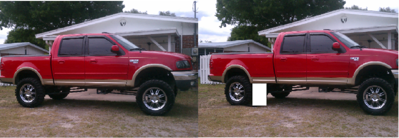

I have mulled over this project idea for 2 years now, i even made up a mock picture of what my truck would look like had i done the project.

Heres that picture of what my truck would look like with a 6.5ft bed, just to give you a general idea of what to look forward to!

That's definitely the way should have looked from the factory! Might have to talk to local body shop to see what it'd cost to do... going back and forth between keeping mine and doing this or buying a new 5.0 157"
